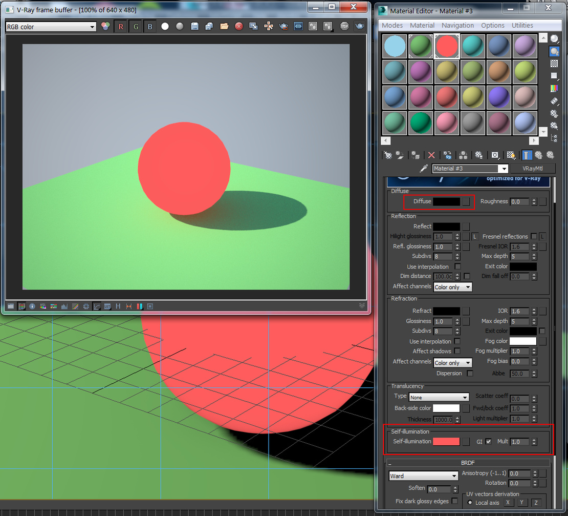

        or, using Self-Illumination property in VrayMtl with black diffuse color.

            Yeap it works(it was the last thing I tried actually), but again the color will not be 100% flat, there will be a very slight unnoticeable shading.

              Svetlozar, the Self-illumination trick on a black material is extra nice. Very quick to setup.
