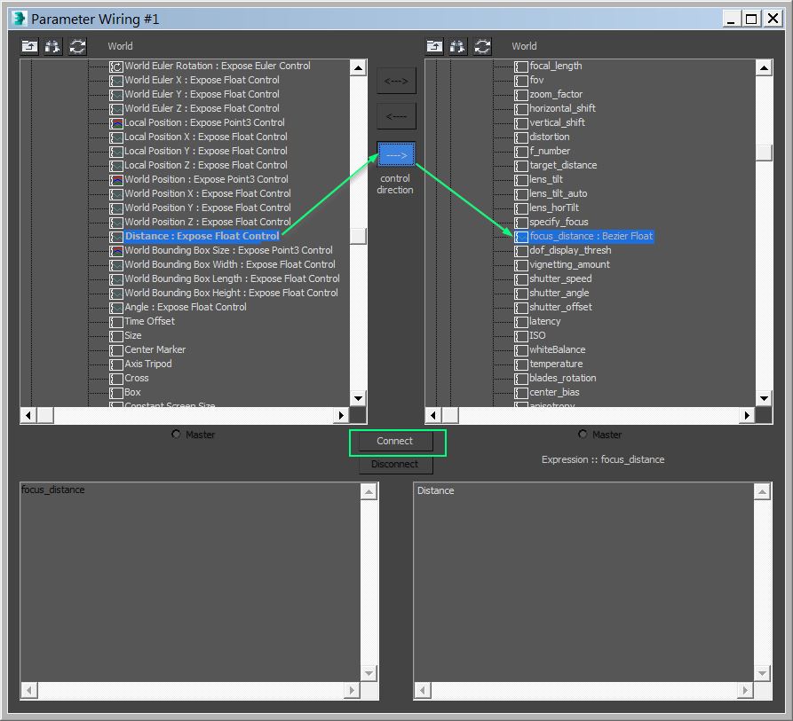

Then you can use ExposeTransformHelper.
This tool could also measure the distance between two objects and then you can wire its Distance Parameter to VrayPhysicalCam Focus Distance one.

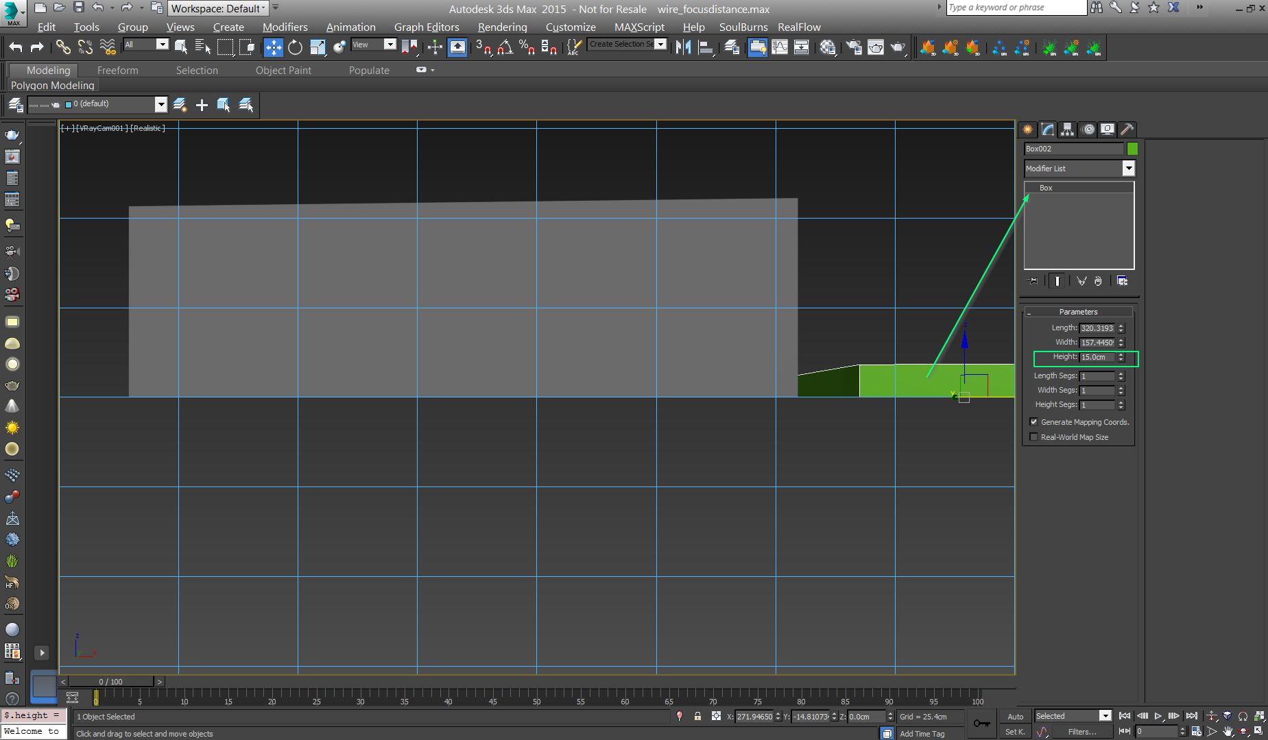

Here are two sample setups:
http://ftp.chaosgroup.com/support/sc...distance01.max - this one use two dummy objects parented to the box and the camera.
ExposureTransformHelper calculates the distance between them and then pass this value to VrayPhysicalCam.
http://ftp.chaosgroup.com/support/sc...distance02.max - this is basically the same idea but instead using additional objects the distance is measured directly between the box and the cam.
