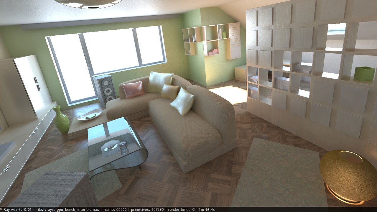

                      quick update on my testing.. i used the rt gpu benchmark scene, and calculated a flythrough lightcache, on relatively (for a lightcache) high quality settings.. took 15 mins.
                      i then rendered out 100 frames at 720p, with a noise theshold of 0.003 and a passes per pixel of 1100. its still a bit noisy, particularly the wicker lamp in the foreground, BUT
                      it rendered in more or less 4 mins a frame ( ignore timestamp)
                      this means 100 frames rendered in under 7 hours.
                      that is damn fast for a single gtx 670.
                      expect under 1.5 hrs for 100 frames on a single titan Z (anyone wanna test it? i can upload the scene and lightcache)
                      obviously being lightcache, the GI looks crap. but should be a good indicator of the speed with a nice imap too.
                      single frame here:Click image for larger version

                      i did let it run to see how long it took to get completely clean, but it seems hard to shift the last bits of grain. im not sure if there are some adjustments i can make, ive barely used rt gpu before. i got to lets say 90% clean in about 15 mins. but the difference in noise between 10 and 20 mins seems negligible.
                      15 minute frame here:
Name:	15 minutes.jpg
