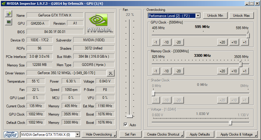

            Hum, interesting all this OC thing.
            I also noticed that using EVGA precision doesn't always reflect my OC to the render.
            It seems I can't OC though the P2 using the inspector though as my slider is already at the maximum.

            What is P2, P5 and P8 anyways? What do they represent?
            Stan
            3LP Team

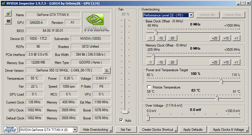

              they are power states that the gpu uses.. p8 -12 being low power states (idle, 2d workload, video workload etc) and the lower number states have increasing clocks. p0 being the highest state of the card for gaming. p2 is a slightly lower clocked state, presumably to guarantee absolute stability for compute workloads.
              wrt turning up the p2 memory clock, 2 things:
              firstly, it will never go higher than the p0 state clock, so you need to set that first.. note they use different number for the setting. p0 is an offset, p2 is actual clock.. f.e. i set my ram to +510 offset in p0 (for starters) then apply. look in the main nvinspector panel what clock that gives you, then go to p2, and turn the slider up to the same or slightly lower. you may need to hit "unlock max" in that window to adjust up.
              note the max you can set is 4000 mhz there... you can however edit the saved "clock shortcuts" and turn it up higher.
              secondly, you cannot edit the clocks if there are any cuda apps open. close rt server to allow changing the clocks.
              finally, and ive no idea why, the p2 core clock setting has no effect. the core clocks still come from the p0 setting.
