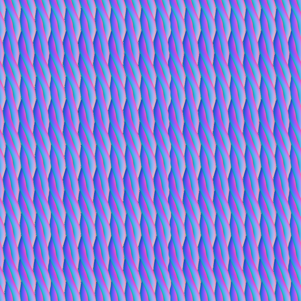

      Thank you for the reply. My problem isn't that I don't know how to bake, it's that I can't get it to bake on GPU. At all. Here are two screenshots, one using GPU, which shows only the plane without the baked geometry, as the corresponding normal map, which is included shows. As you can see from the CPU bake, the geometry is there, as the normal map shows. I realize they're not the highest quality, it was only a few minutes rendering to get the point across.
      Thank you for the time, Alexander.

        Hello Logan,
        I misunderstood your question the first time. Sorry about that. Thank you for the information and the screenshots provided. They were most helpful.
        I see you are trying to use projection baking, but unfortunately that feature is not supported on the GPU yet.
        The GPU currently supports only standard texture baking.
