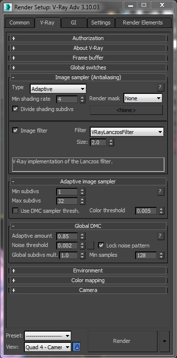

                          I guess I just envisioned it as just a map slot box right next to the noise threshold input (see attached). I have to be honest, I don't always use the vray physical camera. Getting the co-worker to use it is even harder. We still work with some scenes that were converted over from another renderer, so converting the cameras was never a priority as they rendered fine. But I don't want to be the one to hold up progress, so....Off topic: (Is there a script that converts a max camera into a VRayCam? And, be able to create a VRayCam from current perspective view?)
                          So this brings up a couple questions/comments.
                          Having it with the VRayCam would be good for scenes where I have multiple cameras, as each one can have its own map. Just as long as I can set the noise threshold map without actually turning on the DoF, as the whole point is that I do that in post.
                          How will this work with Max 2016, and the physical camera built into the software going forward? Do you have the ability to update that camera with VRay updates? Or will we have to call out a VRayCam with script?
                          Having it in the render setup allows it to work with cameras other than VRayCam. Could this work as a global map, unless a camera with a map is used then it would be overwritten?

                            well, the global control would be quite risky: if you had the map done for one point of view, and not for others, the renderer would still use the global map for different points of view, likely wrecking havoc.
                            (If i am getting what it is you ask for correctly, of course. I thought the map was to be an output, but then, you posted the UI mockup with an INPUT map slot...)

                              I guess it depends how reckless one was. If using a falloff distance blend and direction by object, it would work for any camera, as long as that was the focus. Like in a product shot. Or if every shot was known to focus within the first couple meters, a falloff distance blend from the viewing direction would cover it all as well. But you are right, it would be chaotic where your DoF might travel all over, or camera distances widely varied per shot. But if it could be used sampling something that might be scene wide, it might do better as a global? Like you mentioned light contribution. Could also be by objects, which could be controlled by vertex colors.
                              But I'd be happy if I got the control anywhere really, I'll adapt to it.
