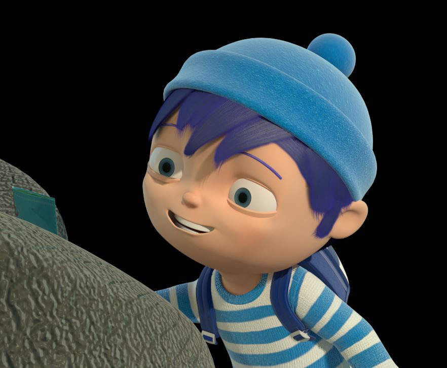

              One computer on the farm hadn't been updated to 3.3, therefore it was writing the files with the old names, but looking at the RGB pass I noticed how different the shadows for objects with opacity maps look.
              It seems like 3.3 is ignoring the opacity map for the shadows, while the 3.2 computer was doing them perfectly:
