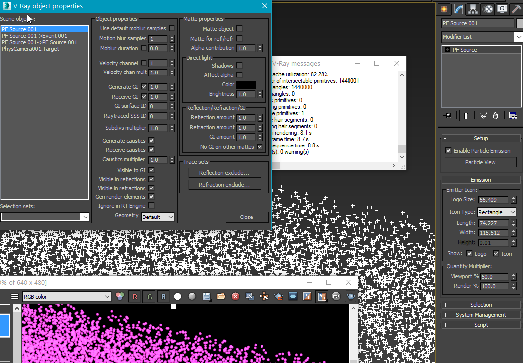

        I don't know about the additional M.blur pass in this case, but in my test setting the samples to 1 removed the blur from rendered particles.
        Have you set the Motion blur samples to all Pflow events?
Name:	2016-01-27 14_31_01}.png
        Tashko Zashev | chaos.com
          hm.. no i just did it to the pfsource. ill try again with all events selected.
            Yes, try it. I did that for all events to make it work.
