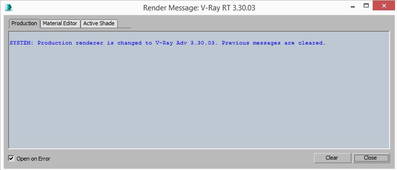

    Does anyone know what happened to the old vray log message window in VRAY 3.3?
    Am I doing something wrong, the old one used to give me useful info about how many DR spawners I had working upon startup etc, etc...
    Now I am getting this message window that looks like the mental ray error message window
    even the new VRAY 3.3 docs show the old message window
    somebody please tell me what I am doing wrong
    thanks in advance

    There's nothing wrong that you are doing; we experimented with using the 3ds Max render messages window, since there is an API for it for 3ds Max 2016. However this turned out to be not such a great idea, so we reverted it back for the next patch.
    Vlado

        I don't mind the new message window, if there is a way to see the DR spawners that are being used,
        You can right-click in the Max window and set it to show informational messages - you should be able to see the DR servers listed there.
