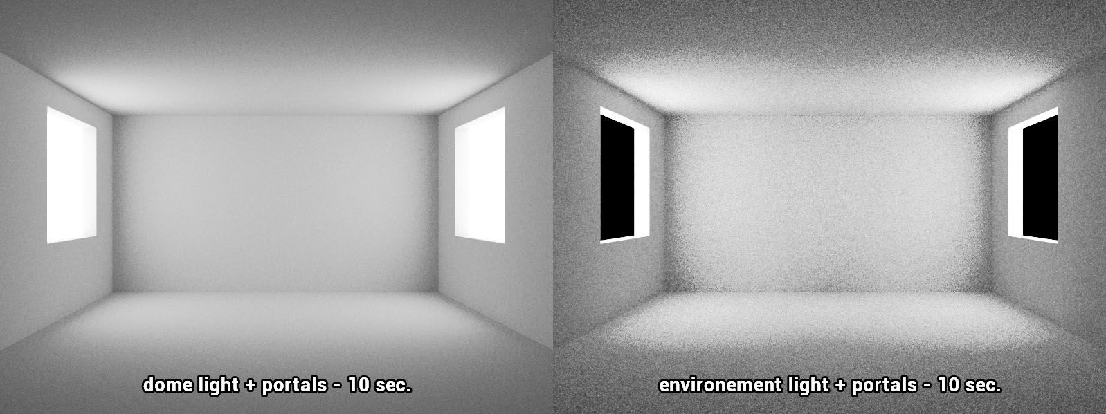

        I'm having a lot of troubles getting dome lights to work decently with interior scenes. They add a ton of noise even if I use light portals. This happens in basically every interior I use dome lights. Am I doing something wrong or using dome lights for interiors is not advisable? In my tests using the environment slot for lighting produces 3-4 times less noise than a dome light.
        Here's a test with default vray render settings.
        PS: Please switch around the text, the noisy result is with the dome light. Sorry for the mistake.

          Apparently you have reversed the results in the image above.
          Keep in mind that there is a known issue with VRayDomeLight and portal lights. Until we fix it we don't advise you to use this combination. You can either use the environment option or the dome light without the Portal lights.
          Zdravko Keremidchiev | chaos.com
            Yes, sorry for the stupid mistake, the text should have been swapped around. The problem is that with or without portals, dome lights are still significantly noisier for interiors. Ok, I'll use the environment slots until the problem with dome+portal is fixed. Thanks for confirming the issue.
