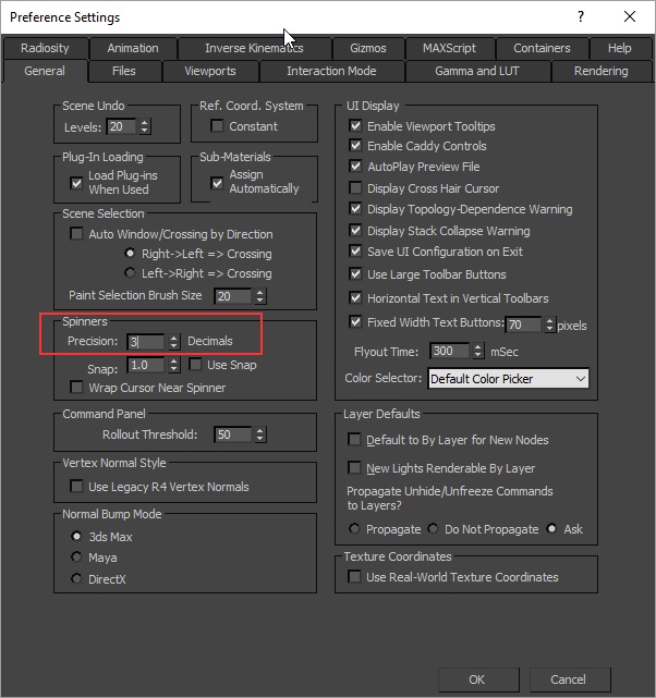

      Default precision value of 3DSMax is 3 if you increase that value you will be able to enter lower values than 0.001
