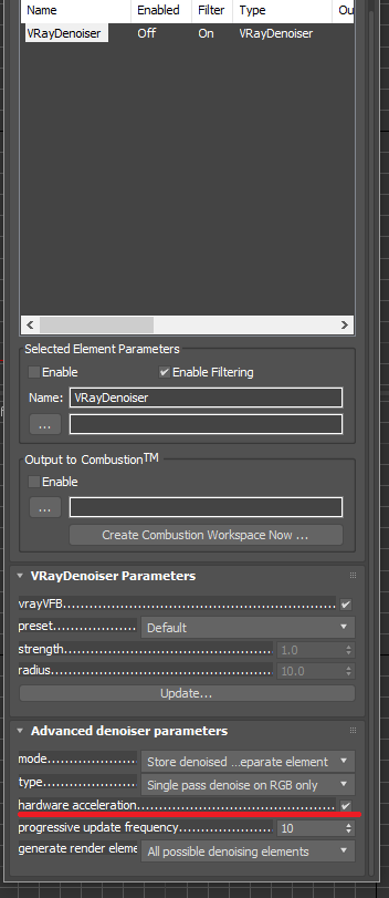

      How can I set the Denoiser only on cpu? I have an Nvidia K2200, but when denoise working pc almost stops.
      sorry for my poor language
        If you turn the "hardware acceleration" option to OFF - denoiser will use the CPU.

          Thanks for help. You are saved me!!!
