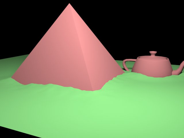

                2000 years after humans, Pyramids and giant teapots are being buried by mysterious green sand...
                I know its silly but I couldn't help it...
                -Alan
