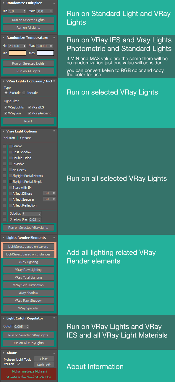

                you can use my script as well if you want to.
                download version 1.20:
                MohseniLightTools_120.zip
                Mohammadreza Mohseni
                Website | Instagram | E-Mail | Art Station | Behance | Twitter | Facebook
                  thank you mohammadreza, nice script. if you can add the directional parameter and the multiplier options like "units" then it would be very helpful.

                      for sure I will add it in next weekend. thanks for feedback.
