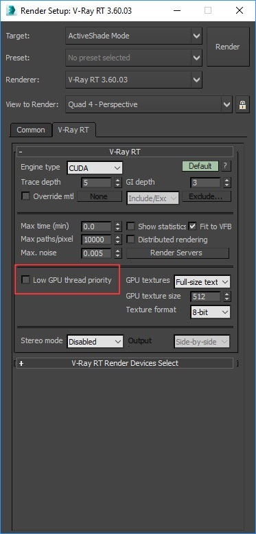

          It is actually not recommended to change 3dsMax affinity and priority from Windows Task Manager since it could affect the stability of the application.
          3dsMax has a internal command for controlling the number of cores used for rendering, V-Ray also have such option via VRAY_NUM_THREADS environment variable, and it also have Low Thread Priority option in System and in ActiveShade settings:
          http://ftp.chaosgroup.com/support/sc...9_15-13-29.jpg
          http://ftp.chaosgroup.com/support/sc...9_15-14-08.jpg
