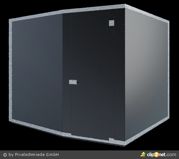

    in vray next the exclude from reflection option is broken... https://c2n.me/3USxxM7.png
    it doesn't exclude the reflected object, it makes it black but still visible
    the image should look like this https://c2n.me/3USxIYV.png
    is this a known problem?

    wow, I have made some tests, and if this is a problem with vray next, then this is really bad for me, because I use the option to exclude something from reflections all the time...
    it seems you cannot exclude anything from reflections.

      Yep, did a quick test and it happens here too. Looks very similar to this problem I reported just a couple of days ago.
          They look very similar indeed. The workaround until it's fixed is to use Trace sets.
