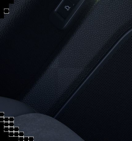

                            I have a scene here showing the square artifact as well.
                            • #15
                              Is there a new build I can test to see if the problem went away in the image shown above?
