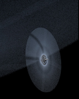

    Hi,
    I`ve got motion blurred helicopter blades, but when the main rotor renders in front of the rear rotor you get a strange stripe. Is this right ? It might be correct I don`t know but it just looks weird.
    2016 with Vray 3.4.0.03 but I`ve also tried 3.6 latest nightly as well.
    cheers
    anthonyh
    hmm interesting, a few questions - is this shape in alpha? or perhaps its specular / reflection? Can you check the aovs and see if it shows up in any of them. Also if main rotor is rendered on its own does it have that issue, same for small one?

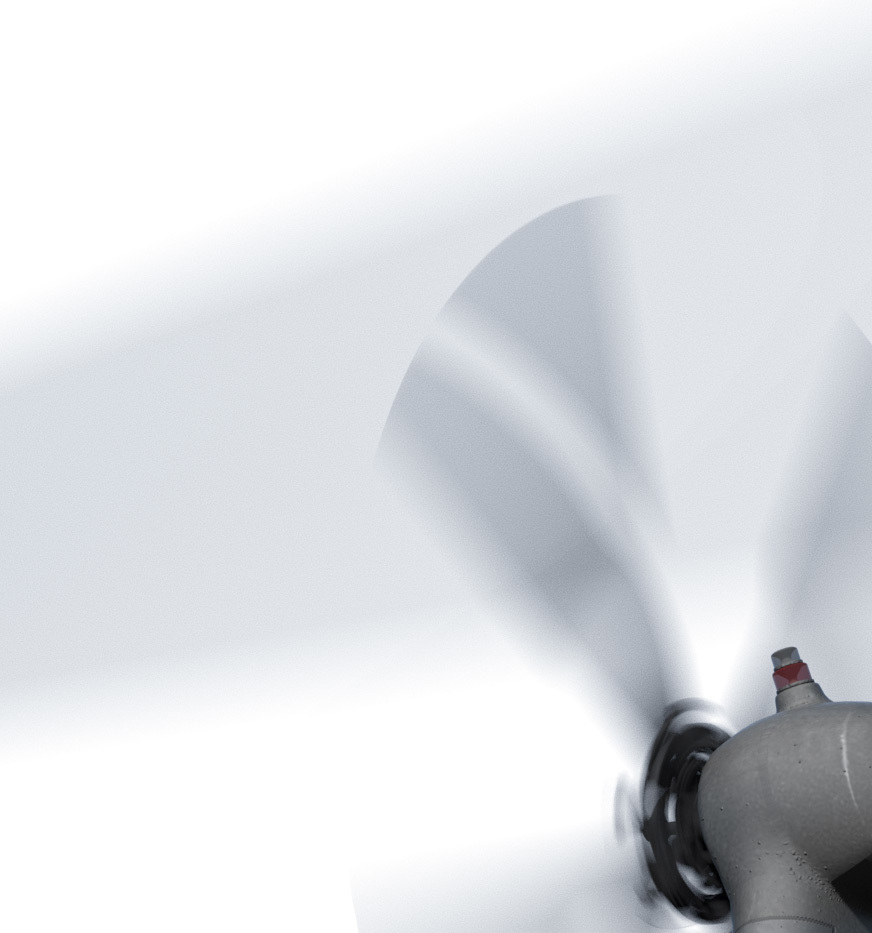

      Hi,
      thanks for replying.
      I checked and it does affect the alpha(see below), it`s more transparent along that strange curve.
      I checked each rotor individually and they work fine, no anomalies. This only happens when rendered together so that would rule out reflections/specular I`d think ?
      I tried a different view and the same thing happens. I`ve also tried without lights/shadows/reflections/glossy effects, override material, bucket/progressive. Turning everything I can think of off/on, reset Vray too.
      Here`s the view of the alpha with faster rotation that shows the anomaly a bit better.

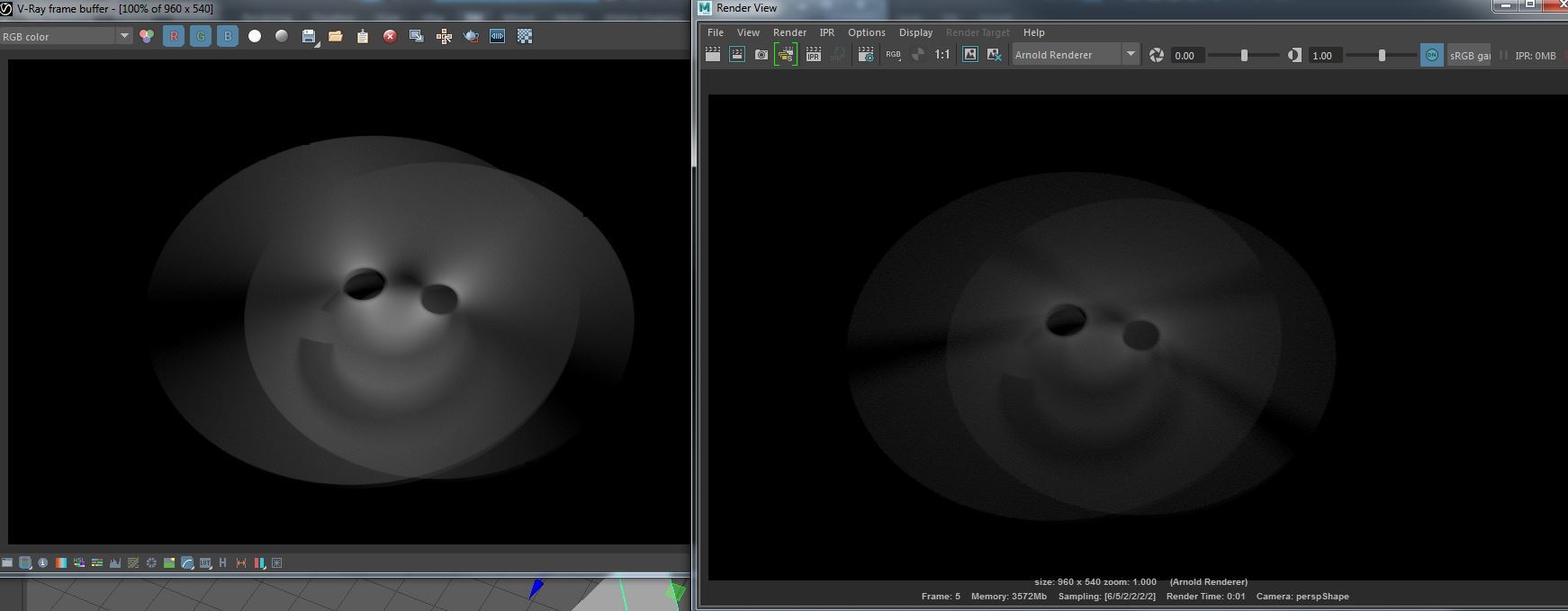

        So this is interesting, I got the same effect as you did in few minutes of testing. I'm not sure, perhaps the devs can check out this scene it appears to be shading anisotropy but I don't think its correct.

          So then I tried this setup in redshift and arnold, both produce those kind of artifacts so I suppose its correct
