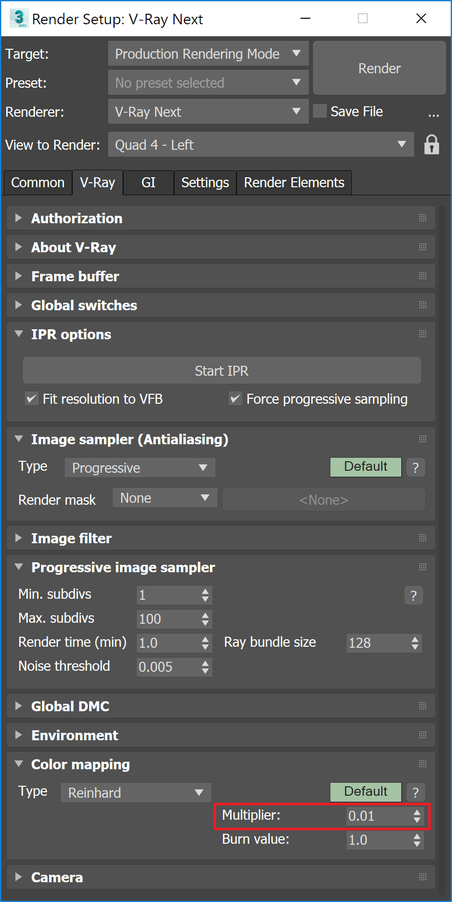

    Generally in 3ds Max the exposure control is supposed to be applied to the viewport rendered image (although I've never actually seen this working correctly) so technically it shouldn't be included in the baked texture maps otherwise you would get double exposure. But of course this doesn't help if you are baking to an 8-bit file format, so it might make sense to include the exposure... not quite sure what to do here. For the moment, you can go to the "Color mapping" section of V-Ray and set the "Multiplier" to a lower value like 0.01.
    Vlado
