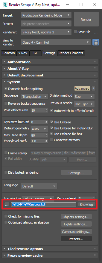

      I finally figured this out. Unknown to me, my old default file was using c:\VRayLog.txt. This was never an issue up to v3.4, but after that all older files (and your Default MAXSTART.MAX if you use one) needs to be changed to %TEMP%. And I should point out that after changing the path you need to save the file and restart Max to reset the temp variable. My files zip right through "transforming vertices" and "loading bitmaps" now.

        Yeeha68, can you elaborate on your method above re %TEMP% not clear on the process am afraid.
        Thanks.
          I suppose yeeha68 means the option in the settings tab (see attachment). You can delete the text and leave it blank and see if it helps.
          Vlado
            Thanks Vlado, it was already set they same as your image, will try with it blank. Testing it now...
