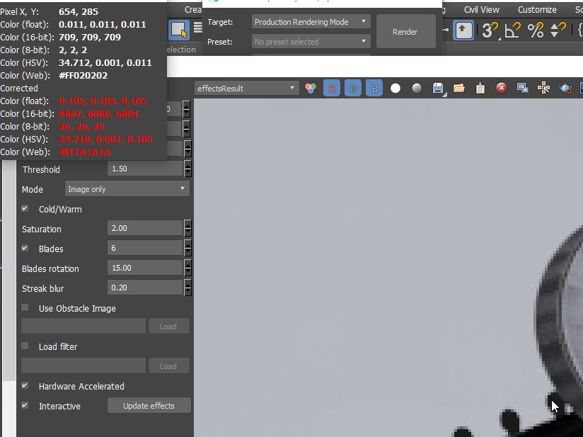

                  Speaking of the LE. I have no issues getting it to work. But why is it when I put a dome light with a hdri in the texture channel does the LE not work? See the 2 enclosed examples.

                    If you check the intensity of the pixels, it is the same?
                    Vlado
                      Hmm, not sure I will check that.
                      Cheers
                      Alex
                        Vlado,
                        So I did a render with and with out the hdri on. Here are the results.
                        Cheers
                        Alex
