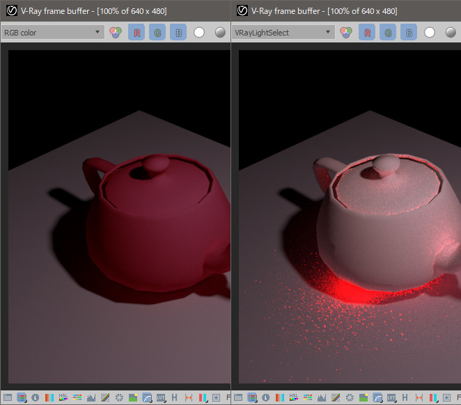

VRayLightSelect Element does not support Shadow/Light mode of The Falloff map.

    why?
    Confirm with V-Ray Next Update 1.1

    I think shadow/light was never supported.
    I distinctly remember it being the case in 2013 during the production of Oblivion.

      Thank you for response.
      If it is an unsupported item, I would like to add it to ToDo.
