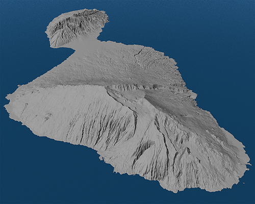

    I've attached a simple example of a landscape, by using the above-mentioned method. The heightmap is generated by free sources on the internet.

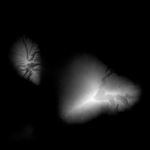

        Hi, I have a few questions. Can anyone tell me the specific workflow in Maya? I have the vray displacement assigned to a nurbs plane, a maya file node with my image in the Displacement mat. slot and have added the vray Displacement control att and set it to 2D Displacement... not sure what im missing.
        I did this long ago in MR with 16bit images.. which brings me to my second question, how to convert my sdts data to 32bit images, i had used pullSDTS but it will only export 16bit
        Maui, Hawaii (where i live)
          Displacement on NURBS geometry is not supported, use polygon geometry instead. Otherwise, the workflow is correct.
          Regarding your other question, maybe use another similar third-party application.
            If the data is originally in 16 bit, promoting bitness will do nothing at all to it, besides make the file larger on disk and in RAM.
            You would need to also dither the detail so to get rid of the banding (i assume it's what prompted you to try and convert to 32bpc.), which isn't trivial when it comes to displacement.
