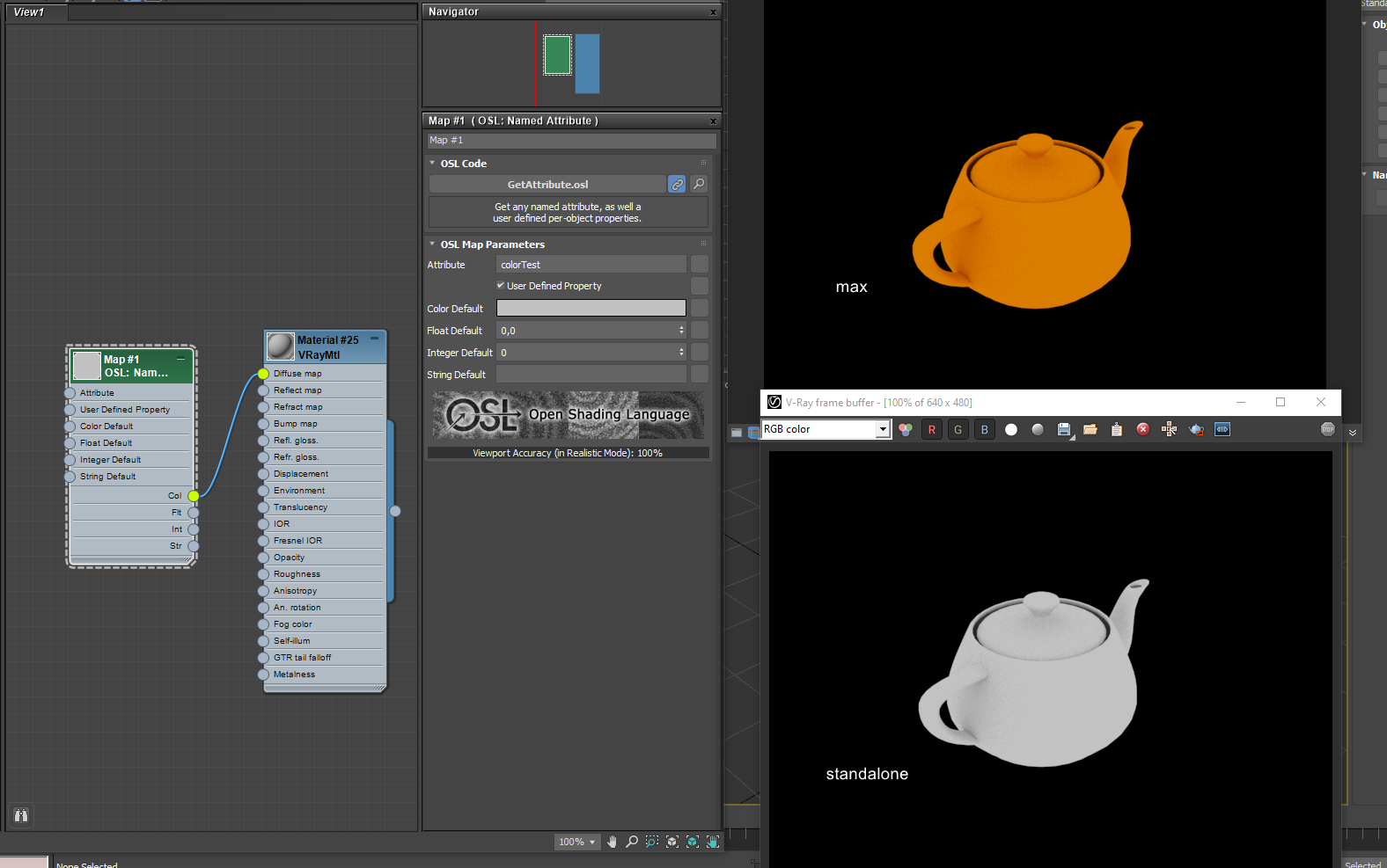

    I have another problem with max osl to standalone export (please also have a(nother) look at this thread which I updated with more problems: https://forums.chaosgroup.com/forum/...-render-result ) .
    Here I'm trying to use the OSL version of the VrayUserColor node. It renders fine in max but turns out gray (the default) in VrayStandanlone. Please have a look at the files below (userprops_vray_bugreport.zip + screenshot).

    Hello,
    If you take a close look at the OSL shader source code you will see that when the "User Defined Property" checkbox is checked the code adds a "usr_" in front of the user property that you have chosen (That way it finds your user property in 3ds Max itself). If you uncheck that checkbox you will get the correct result in standalone.
      Yes but that's exactly the issue and purpose of this bug report. If I have it activated it only works in max... if I have it deactivated it only works in standalone. It never works in both. I need it to work identically in both applications, otherwise the whole export process and standalone workflow is pointless (It would consequently also fail in the vray cloud of course).
