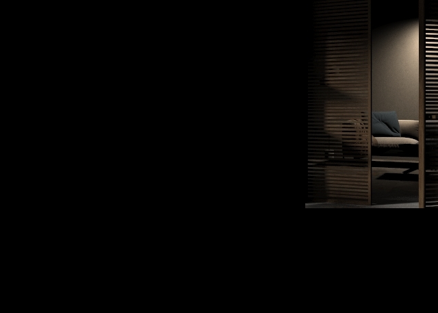

    Hi, today i notice that if i use a VrayLightMaterial inside a MtlWrapper with the Generate GI disable the Lighting RE do not corrispond with RGB.
    If i disable both Consistent Lighting Elements and the Adaptative dome option in the DomeLight the problem is gone.
    I solve using the self illumination of standard VrayMtl without disabling Consistent Lightning Elements and the adaptative option
    Do not know if it is a bug, just to report it to your attention.
    I attach you my test.
    Thanks, Alessandro
    This are with the standard VrayMtl ( Consistent lighting elements and Adaptative Dome are both enable )
