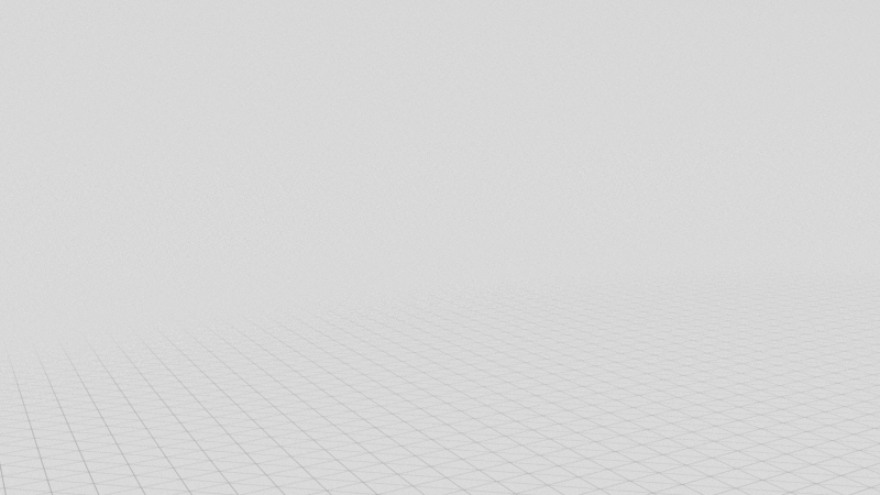

    a transparent mapped plane over a white floor...
    is "work with transparency" in vraydirt not working for gpu rendering?
    on the right the extratexmap rendering.
    Click image for larger version  Name:	gpu_den_.RGB_color.0000.jpg Views:	1 Size:	160.2 KB ID:	1053371Click image for larger version  Name:	gpu_den_.VRayExtraTex_Map__1.0000.jpg Views:	1 Size:	162.0 KB ID:	1053372
    thanks for help !
    thomes
    gpu_dirt.zip
    Yes, the VRayDirt map has only partial support in V-Ray GPU and 'work with transparency' is one of its unsupported features (you can see that the option is greyed out when in V-Ray GPU).
      hi aleksandar,
      thanks for this clarification.
      ...it really not easy to get warm with vray gpu render...it is really a veryvery small scene and first i realized that it is not possible to render direct AO into the frame , now it seems that this extratexmap workaround is also not possible in gpu... boaaa...
