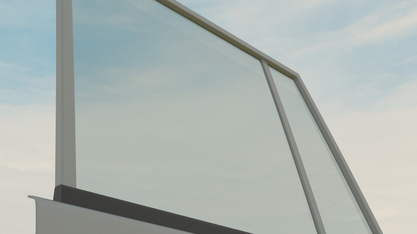

    "Reflect on back side" seems to do very weird things as soon as reflective glossiness value changes to anything other than 1.
    Here are 3 renders displaying the effects on glass with:
    1) Reflect on Back Side OFF
    2) Reflect on Back Side ON, Reflect Glossiness 1.0
    3) Reflect on Back Side ON, Reflect Glossiness 0.999
    no explanation for this??

        Just noticed that this only happens when Phong BRDF is selected.
          Coincidentally I noticed a similar issue yesterday.
          This piece of glass has a turbosmooth and bend applied. With glossiness at 1 there is no issue. In the other bad images one is with .99 glossiness and the other is the same but with the bend and smooth mods turned off, which makes it even worse.
          Justini, weirdly I get the exact opposite findings - all BUT Phong show these artifacts.
          This is with (today) Max 2021 and 5 beta, though it happens with Next lates and Max 2020 the same.
            fixeighted Could you attach the scene here (or send it to support@chaosgroup.com)?
              Sure - very simplified part here. Even just tried the second uncollapsed box as you see it, to eliminate the smooth or other poly stuff. It's Ok flat - turn on the bend and it's screwed
              https://www.dropbox.com/s/3pzqdi3hhf...x?dl=0It's
                fixeighted Thank you for the provided scene. It seems like a newly introduced issue. I've logged it (internal bug-tracker id: VMAX-9978 ) for developer analysis. Using the Phong BRDF mode indeed resolves it and may be used as a workaround.

                      justini Thank you for the provided scene. It seems to be the same issue as mentioned above, manifested differently though the Phong BRDF model. In your case, using other than Phong models seem to suffice as a workaround.
