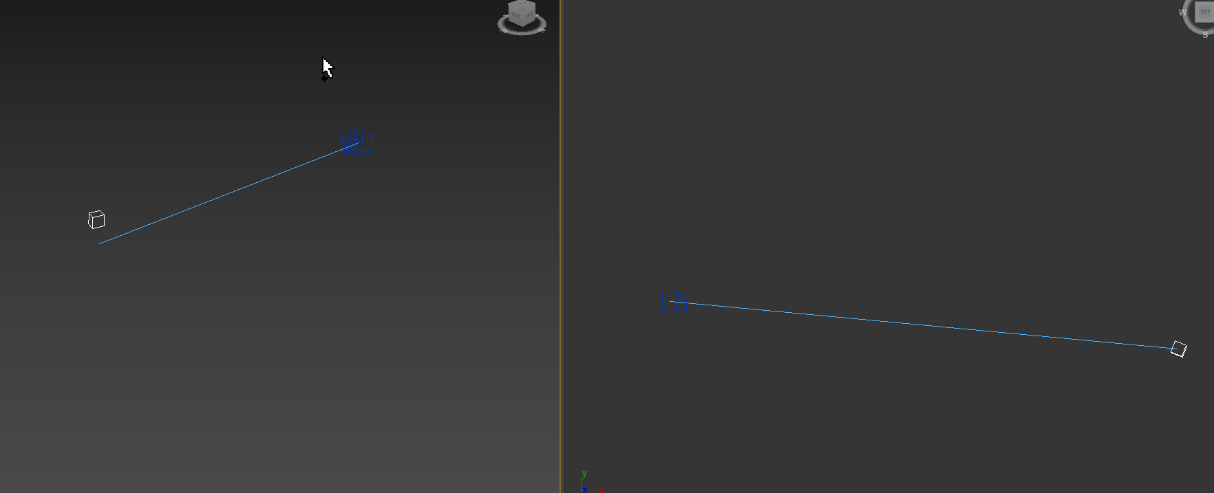

                      I only have a 0.0 target distance for ortho views, and i have asked we change that to a unit (whatever that may be in real units.).
                      For perspective, i couldn't (ever) repro the behaviour, and may imagine it could be due to unit setup, but in that case too i couldn't make it misbehave, no matter how skewed i set the units up.
                      Click image for larger version  Name:	physcam.gif Views:	3 Size:	361.9 KB ID:	1174767
                      Lele
                          it's shown in my gif how to fix it: set camera target distance to anything but zero while the fix is implemented.
