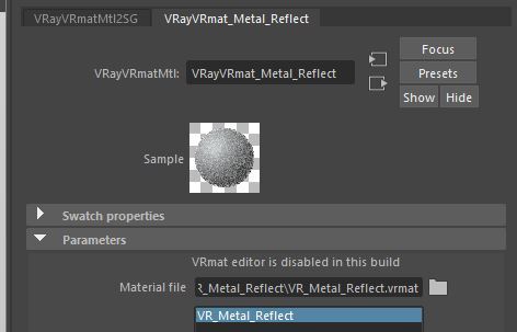

    Attached some self-explanating screenshots after a fist render test.
    I exported from 3dsMax with TOOL > Vray vrmat converter
    It's a simple Metall material from 3dsMax library, even no maps connected.
    It looks reflecting in 3dsMax but just like a dull lambert in Maya.
    Max 2021 and Maya 2020.3, both Vray5.
    ( I know I can of course easy transfer the settings of this example, but this is a technical test and there are also some more complex materials.)
    Thanks.
    Rendering in Maya Vray VFB:
    Click image for larger version  Name:	chrome ball in maya.jpg Views:	0 Size:	2.6 KB ID:	1093179
    Click image for larger version  Name:	maya metall reflect.jpg Views:	0 Size:	16.2 KB ID:	1093181
    And this is how it originally looks in Max
    Click image for larger version  Name:	Material in MAX metall reflecting.jpg Views:	0 Size:	117.9 KB ID:	1093182

    The issue is due to the fact that the "Metalness" and "Use Roughness" parameters are not exported in the .vrmat. Try exporting the material as a .vrscene, which you load in the VRayVRmat Mtl and see if that works out for you.
