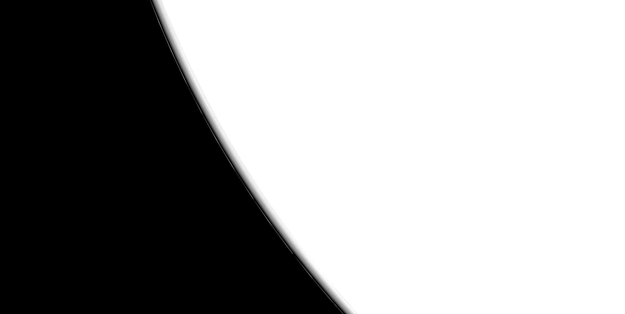

        - i do now have an issue, however, in the alpha channel.. it seems refraction with a falloff gradient in the refraction amount slot doesnt play very well.. at the very outside edge of the atmosphere (which should be totally transparent) i get some glitchy solid bits in the alpha. right along the edges of the outer faces... im going to have to try adding opacity mapping back into the mix with a very tight fresnel to fade out the edge.. hopefully it doesnt kill my rendertimes again.
Name:	alpha issue_diffuse.jpg
Name:	alpha issue_alpha.jpg
          Does that go away if you switch from the default microfacet to blinn/phong? Seems the microfacet can mess stuff up in a few situations so maybe worth trying
            ive actually resolved it by setting ior to 1 rather than 1.001 or whatever... since i was also getting heavy distortion of satellites passing behind atmosphere edge. which raises the question...
            its kind of a mantra here "dont set ior to 1, always use some number slightly above 1 to avoid problems"
            what problems? its never been clear to me, and in my case seems to fix it. however i dont want any more nasty surprises.
