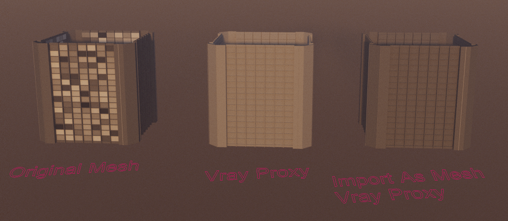

    I hit a big issue recently. MultiSubMaterial Random by Element is not respected on VrayProxies(vrmesh), RenderInstance(tyflow), And import as Mesh from a Vray proxy.
    I have a geometry with separate Elements for windows. Check the image below from IPR. But its the same in the Frame Buffer as well. I've attached the file as well!

    Hello,
    Thanks for the feedback. Our dev team is already aware of the issue it will take a closer look at it.
    Philip

      Thanks Philip. I Wish this one could get a high priority for the next update.
        Just checked whether vray 5.1 proxy respects 'random by element' multisub map. Still nope. Any progress on this one?
          Yes, actually a developer is working on this right now, so I hope it will make it into a build soon.
          Vlado
            That's awesome. Thanks Vlado! Would be great to get it working in viewport IPR as well.
