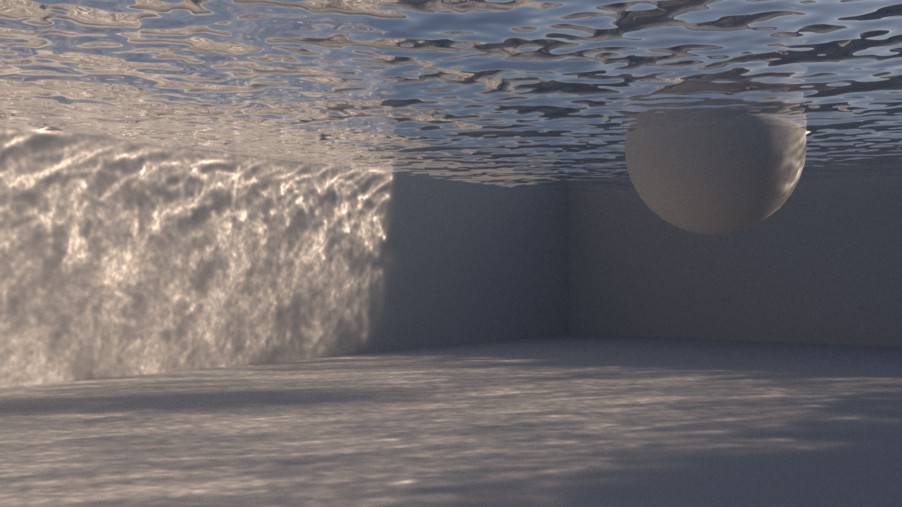

    You can turn on caustics, which you'd want in any case I guess. Then you'll have shadows and nice caustics
      It's a very good catch, in fact.
      I've notified the interested party, will update you as i'll know more.
      For now, as a workaround, set the depth to a high value (say, 1000), turn off "Affect Shadows", turn on Caustics, set them to progressive, and leave the options alone.
      Finally set the engine to progressive, and render away.
      This is what you'll get (after a minute on a slow CPU).

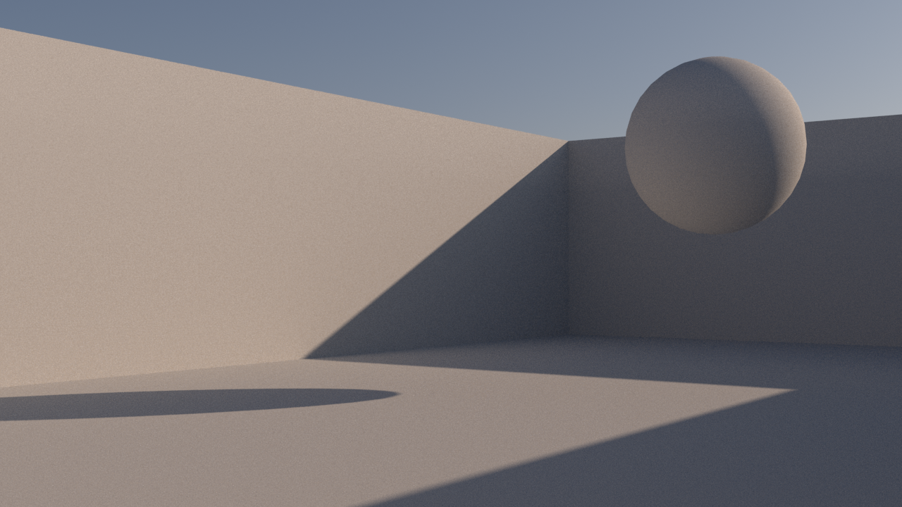

              Click image for larger version  Name:	pool_caustics_01_flat.png Views:	0 Size:	1.25 MB ID:	1105406Click image for larger version  Name:	pool_caustics_02_thick.png Views:	0 Size:	1.25 MB ID:	1105408
              Image A: Water is shaped like a box - which we are inside - so technically a volume, but I know, the light only passes through one surface at top as we are inside of it. Caustics look like i expect - but the only way to have shadows (as far as I have tested) is by also having caustics.
              Image B: Same water box, but now it has a very thin height - so we are looking up through both the "in" and "out" surface. I don't like the look of the caustics in this one - and the water looks wrong, but I get why they look different.
              I don't see a reason shadows/light shouldn't just "work" when observed from "behind" a flat refracted surface. In the example above (because I do like splitting certain stuff into passes and not "rely" on caustics) it would mean having two unique water meshes for the separate passes - which may create unwanted artefacts in the displacement when one of the surfaces goes from being flat->displaced to thick->displaced.
