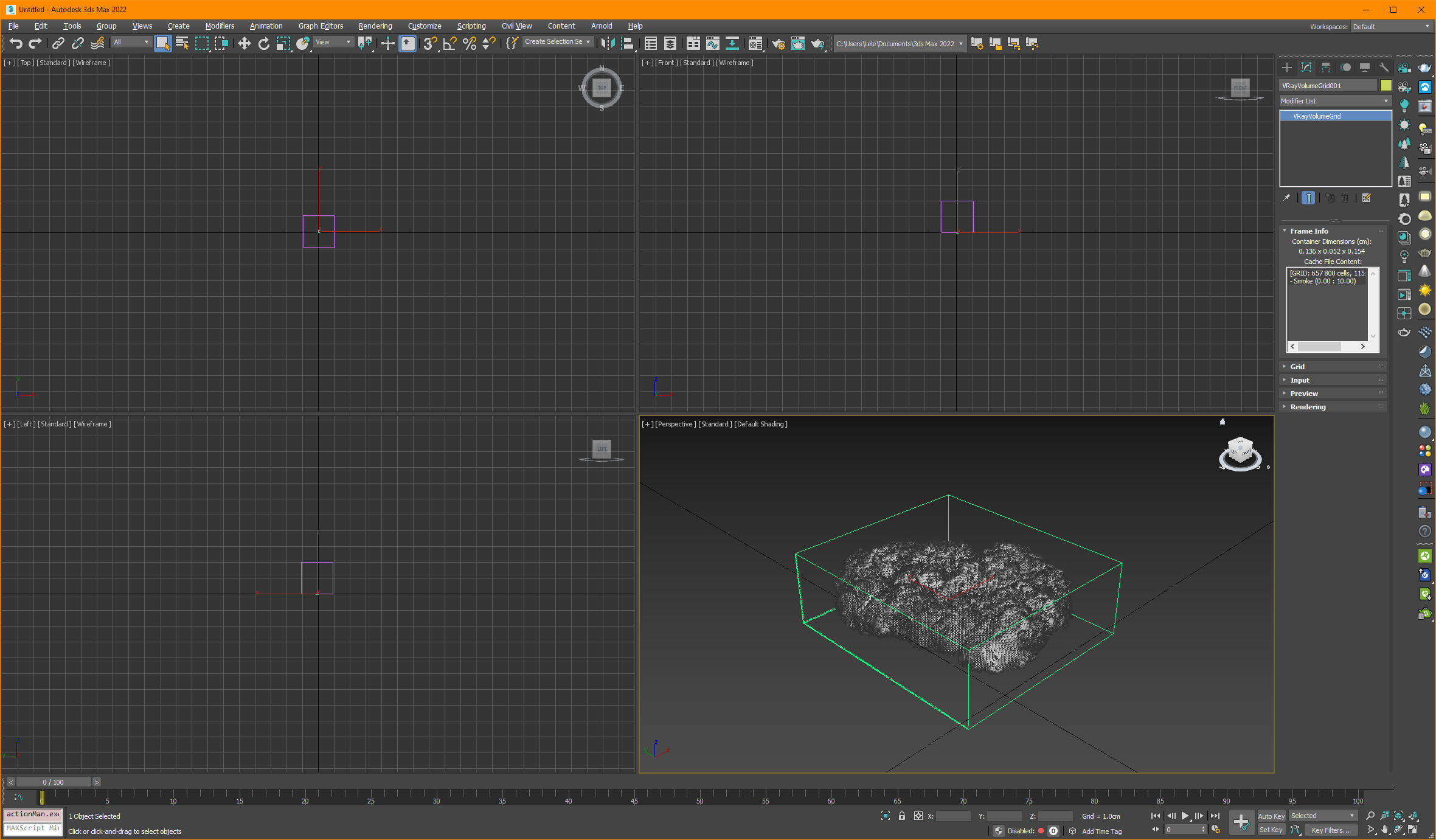

          Hello,
          I'm on 3ds Max 2022 and i have the same problem.
          I use vray 5 and when I load a vdb file for my volumetric grid my volumetric box is empty.
          Can you help me please?
            It does say "no frame loaded".
            You may be loading a sequence, and the frame you're looking at may be empty (f.e. a sequence that goes from 1 to 100, and you're looking at frame 0).
            Verify what the filename is, and in case force it to single file (removing the #).
            Lele
            emanuele.lecchi@chaos.com
            Disclaimer:
              I tried to move around the timeline and still nothing.
              And I don't have a # on the file, do you have any other idea where the problem could be?Click image for larger version
                Looking at the screenshot, the only odd thing seems to be the "time bend controls" "mode" setting: try and set that back to its default of "linear", see if it fixes your issue.
                I could probably do better if you sent me one VDB file via mail.
                Lele
                Disclaimer:
                  I try to change this, but nothing... I send the project on your adress.
                    For future reference, the issue was with a path with a special character in it, which threw Max off.
                    Moving the VDB to a readable path worked fine.
