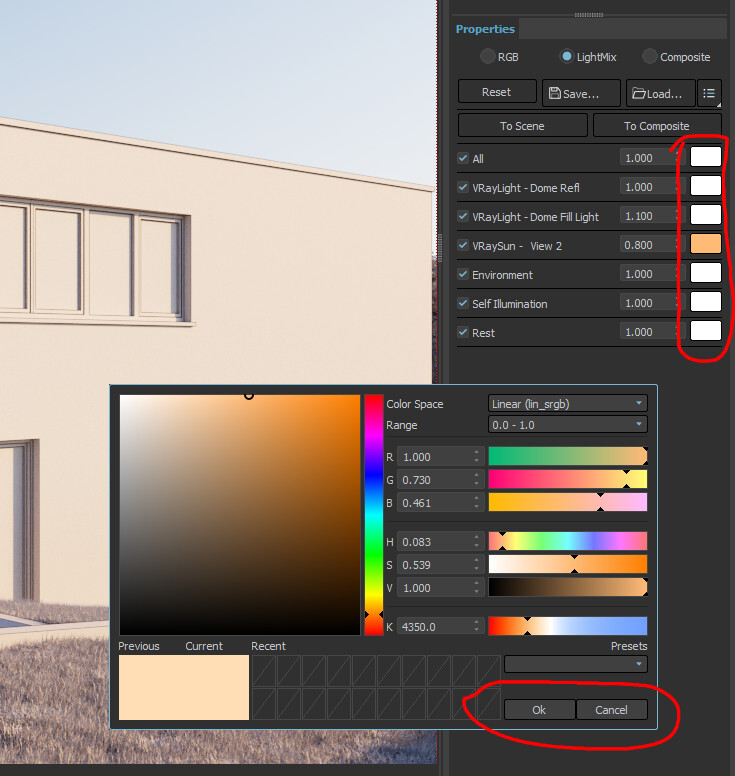

    Hi,
    There are some buttons and swatches in VFB's LightMix panel that don't react if I click on them in a specific way. Please see the screenshot below. If I click around the edges of the ones marked in red, they don't react. I can still see them get highlighted which means that they should react. They only react if I click in the center. So I often find myself clicking 2-3 times before I can interact with them. Other buttons and swatches in VFB and LigtMix don't have this issue.
    Click image for larger version  Name:	Vray_VFB_buttons_not_reacting.jpg Views:	0 Size:	123.8 KB ID:	1115222

    Seems to be working as expected on my end. Are you certain you're not dragging the button, rather than releasing after the click?
      Yes, I'm positive that I'm not dragging. I've just made another finding that might help demystify the problem. When I click the button around the edges, a dashed line appears inside the button. I noticed that the button doesn't react only if I click it in the area encompassed between the button's edge and the dashed line. If I click anywhere from the dashed line inwards, the button reacts. Please see screenshot below. I don't see this dashed line appearing in the swatches, but I assume the same happens there.

        Confirmed.
        Clicking where you mention actually allows dragging of the panel.
        Lele

          Ah, it seems you are correct.
          EDIT: It actually might be a 3ds Max related issue. We'll investigate.

              Weirdly this does not happen in 21, only 22
