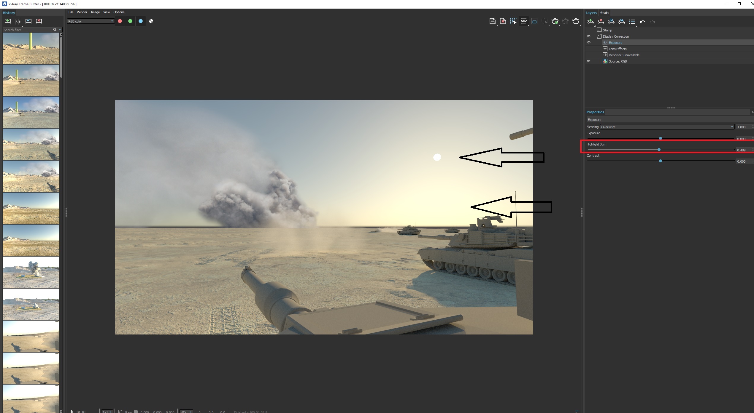

    I having a trouble to understand how Vray-sky works in terms of representing sun and its exposure(It has a huge bloom). I've added a reference and three screenshots, two of which shows my attempts to toggle vraysky and 1 shows vray bitmap hdri.
    My question is, how should I set my settings so I can remove the huge bloom around the sun area but at the same time retain the same amount of sun intensity on the the scene?
    Vray exposure is set to auto exposure, I've also tested with 14 EV.
    Scene contains two light sources, Vray-sun and Vray-dome light with hdri.
ID:	1115493Upper arrow shows location of the sun in the scene and lower arrow shows were vray sky assumes the sun is. Highlight burn is at 50% to show reduced effect &l ocation of sun in vray sky.

    Reduce the sun intensity, and you should be allright.
    Without exposure, at the sun-height you show, a multiplier slightly above 0.01 ought to get you the results you're looking for.
    To do so without changing scene properties, use one of the many possible environment overrides (render settings, materials, or render elements + compositing).

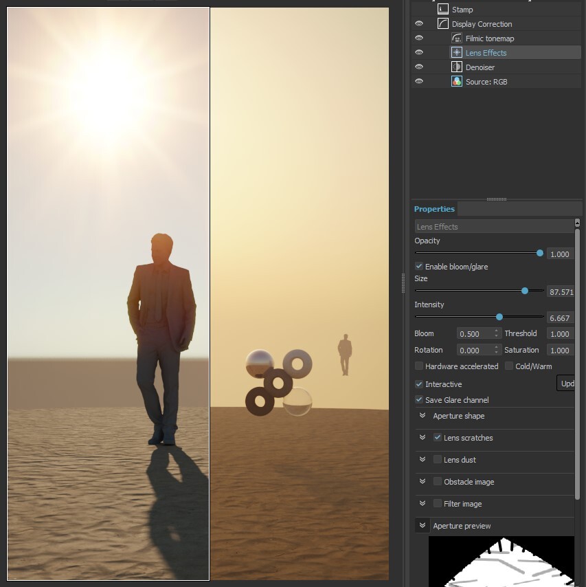

            I would like to add a bit about VRay sun on the desert - ground albedo and turbidity (only in Hosek et al. sky model).
            grab the color of your desert and decide on turbidity. not an expert on deserts but I guess depending on the wind and type of desert it get enywhere within the range VRay supports: 2-10
            aerial perspective with colour might be helpful as well.

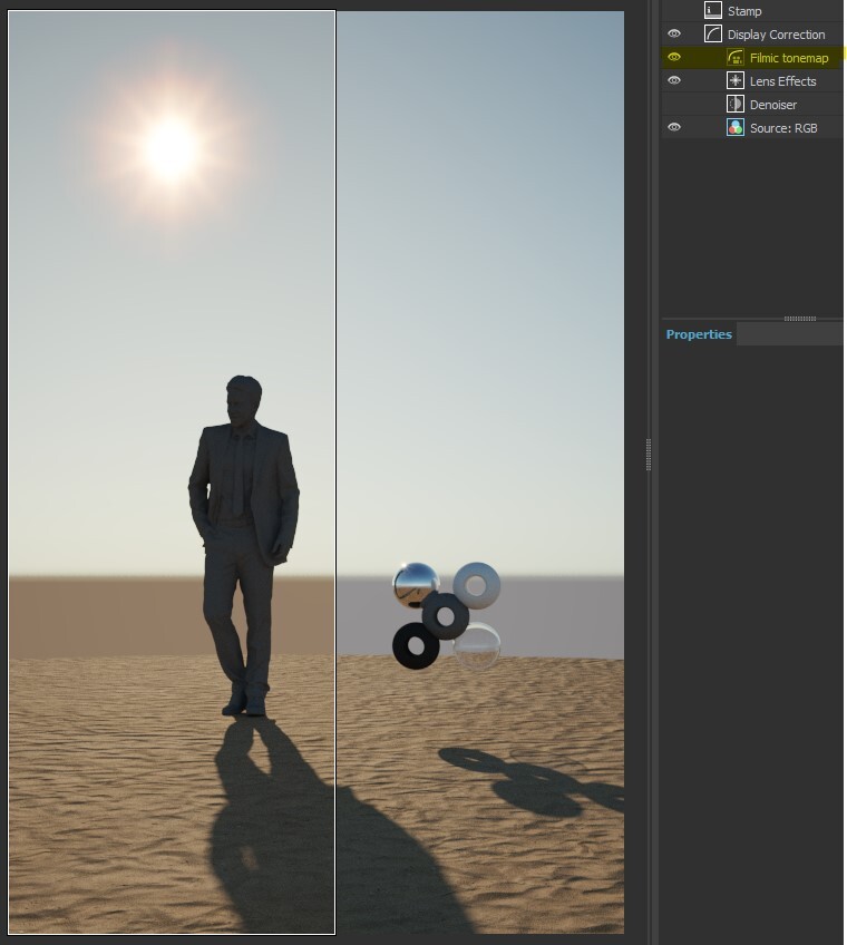

            edit: and use filmic tone mapper. the easiest way to see how it would look as a "photo shot on camera".
            Marcin Piotrowski
            youtube
            CGI OCIO config 04
              and how the bloom size is in the lens effects settings:
              Marcin Piotrowski
              youtube
              CGI OCIO config 04
