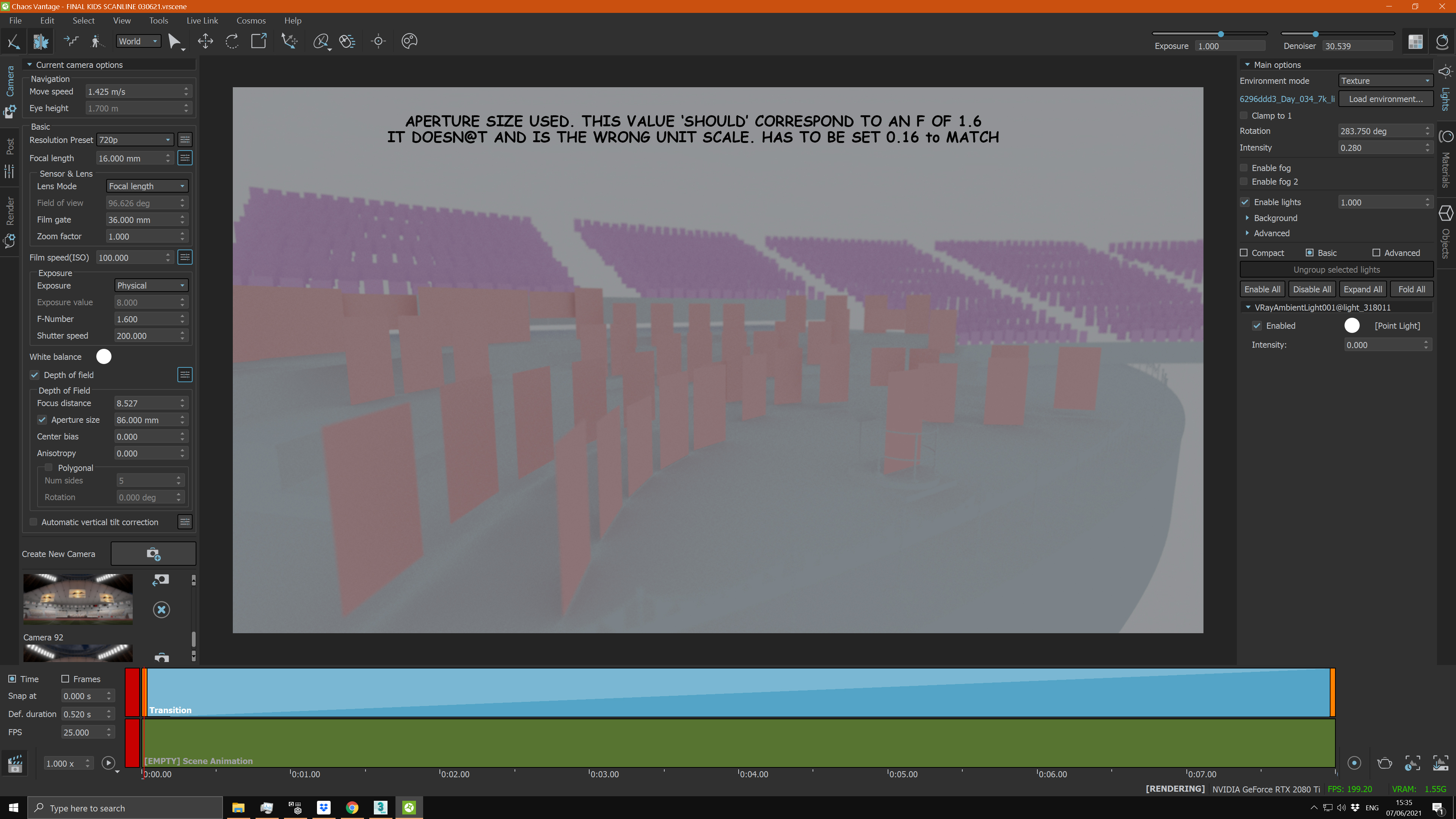

However, given that I need to match cameras that come from Vantage, those cameras, set in Vantage, do not use the same interpretation of values, meaning that I have to also animate the film gate to push the view back into relative position. Alongside this I need to use an online converter to translate Vantages values to Vray camera's values, as they are bizarrely not the same.
All of course making the most basic of operations extremely complicated
Only 52 shots left to go.....*sigh
