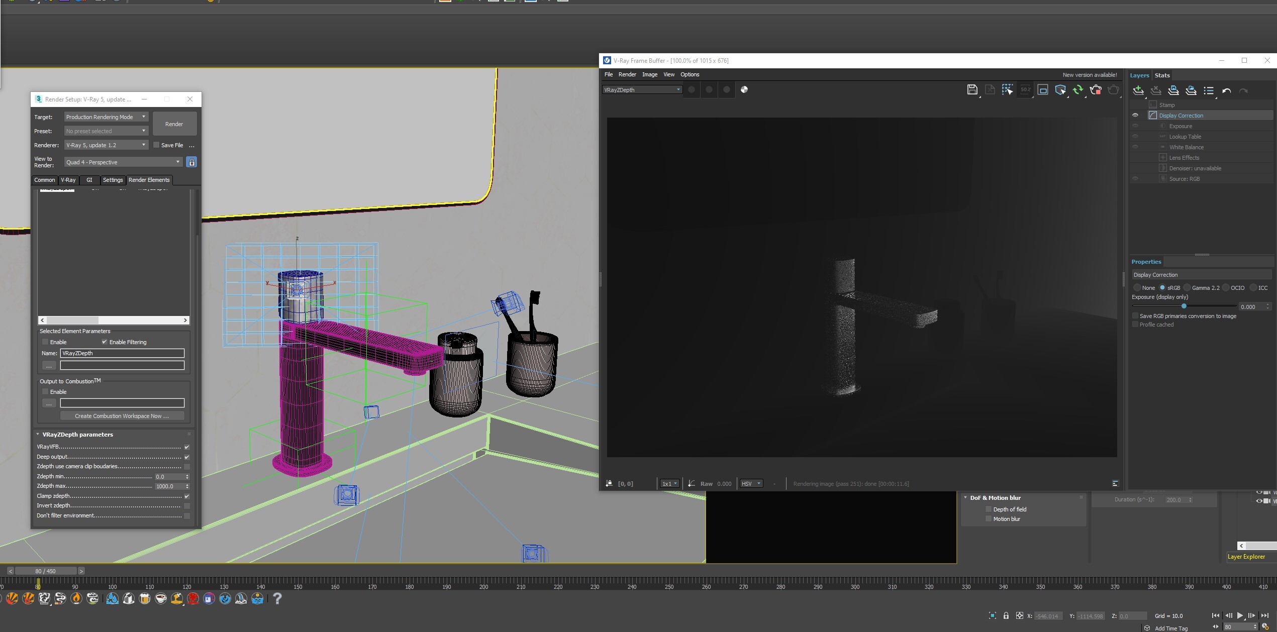

    I'm trying to do a little animation and to save time I want to do DOF in post.
    I'm trying to set up a zdepth...but something looks weird.
    I think the tap should not look like that
    Also, if I change setting it doesn't restart the render in ipr mode, and even if I try to refresh the render manually it doesn't change settings.
    I have to stop it and start it again.
    Is it normal?

          Check the shader, ensuring the reflection part is *not* set to "affect all channels".
            Hi Lele,
            thanks for your help!
            Just because I come from other softwares...what is the advantage to have this option?
            and, like just happened because I didn't know, what should I do to correct the problem?
            I left the option in every material....
              The option is so some data channels get info from the reflection or refraction.
              For example, some users want glass to affect their alpha channels, and there's an option for that, while to denoise stuff behind refractive shaders, one needs to select "affect all channels", so that the normals from things behind it can be stored in the proper normals RE, for example.
              We default to *not* affecting anything else than the RGB, so it doesn't come from a default of ours, i think.
              To remove it, simply run this piece of script on your scene, and you should be good (copy/paste the line below in the listener, press the keypad enter at the end of the pasted line, you should see "OK" printed in blue.).
              Code:
              for m in getclassinstances vraymtl do m.reflection_affectAlpha=0
