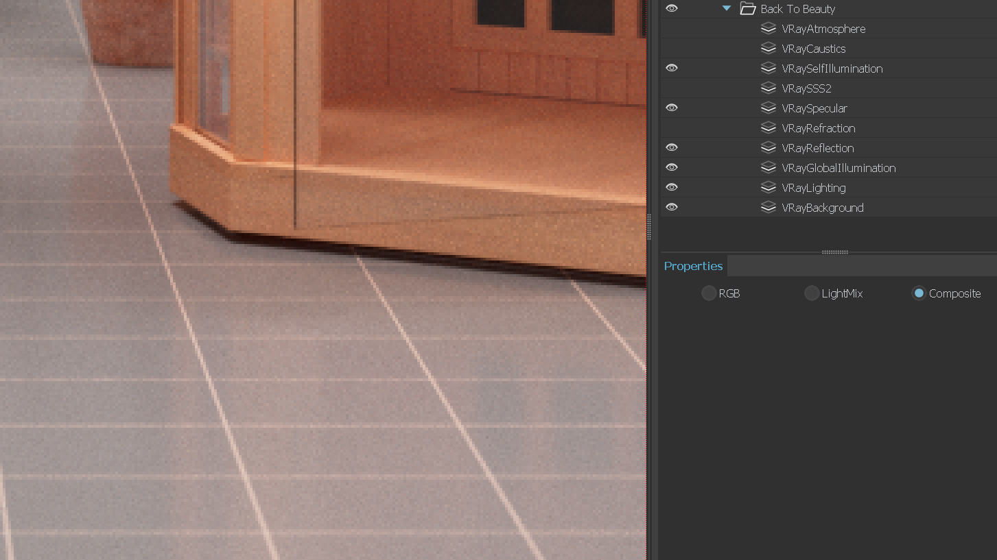

    I didn't expect this so it threw me until I figured out what happens.
    In the composite B2B view, having the refraction turned off is the only way it looks as it should, as you can
    see in the comparisons. So it is adding weird lighting to the scene.
    Is there any explanation for this?
    I figured out why this happens. I had the glass refractions set to 'all channels' for whatever reason, if there was one.
    In any case, why would that mean that it adds light to the image?
      It pluses more than once = lighter looking.

        Yeah I was just at the end of formulating that conclusion
        Cheers for confirming. Maths eh? Mostly a mystery to me
