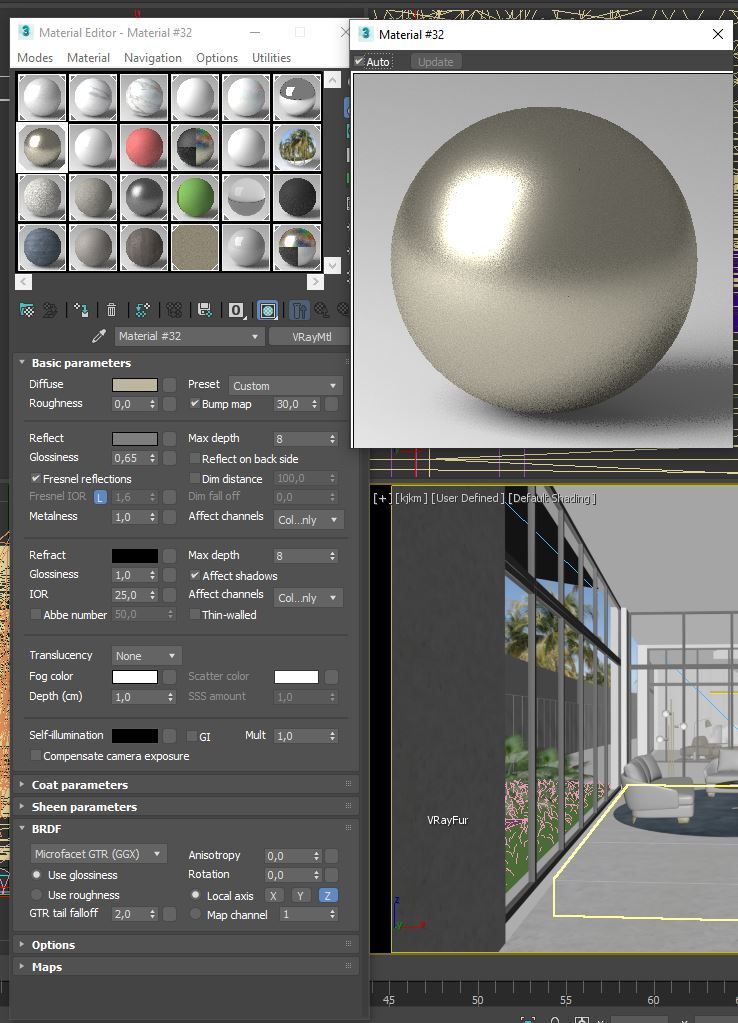

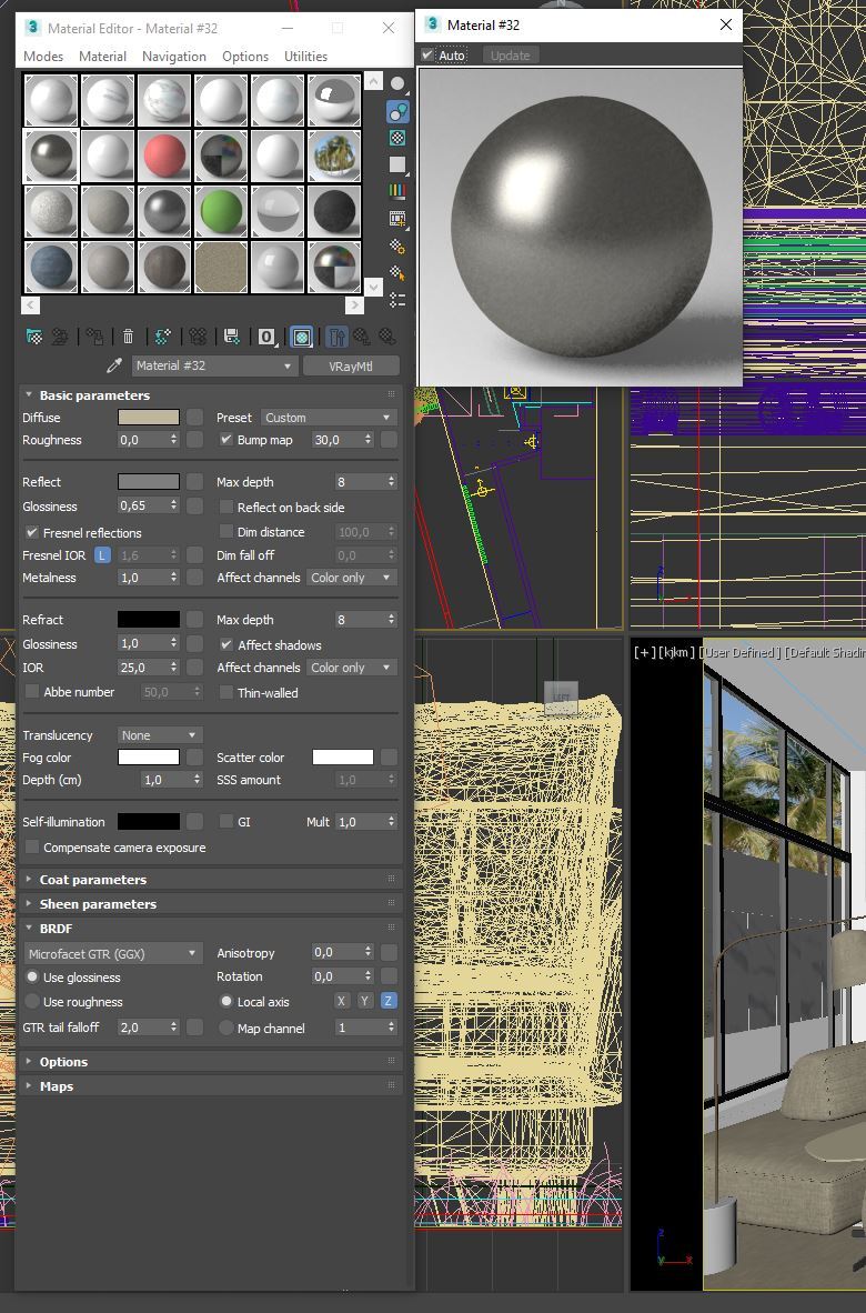

    Good Morning. I have a problem with the new 5.2 upgrade. As you can see when I open my project in the new release( 5.2), the color of the rendered material is totally different. I opened only the file without touching anything. My old version was 5.1.

      I found this issue in this metallic material. this is the only that i clearly see different ( and the only one metallic without texture). the right one is from version 5.1 because, as you can see, the color of the material is similar to that of the diffuse.

          I found that if i unlock the "fresnel IOR" the look will became similar. And i found that if i create a new material with same settings, the material is ok. I think there is a problem in load old scene materials.

              We had a discussion with the QA team about the matter and it seems the darker version is the physically correct one. There used to be an issue regarding a wrong "energy preservation" implementation in metals, which yielded a more vivid colour. I presume the shader was created at that time.
              Otherwise, by unlocking the Fresnel value, the metal has returned to "normal" because of the default 1.6 Reflection IOR (the lock simply causes equal IOR values for refl. and refr.). Simply put, the dark result is caused by the high reflection IOR.
