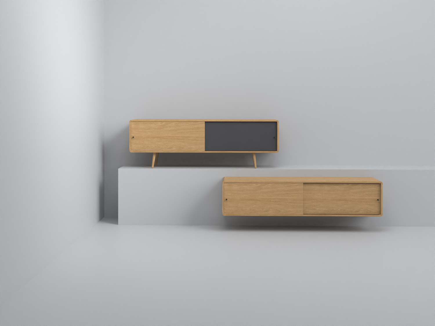

    I have an issue when saving mulitple render elements out to seperate images. I have a basic scene in which I use the Intel Denoiser and the denoising result looks fine in VFB. However when i need to save the different render elements out as seperate png's the RGB Color element and the VRayDenoiser element have different results as you can see in the attatched images.
    Hi how do you save your output? If you have color corrections in your VFB they are applied to the RGB and not to the denoised results.
    If you want to have the color corrections applied to the denoised result you have to enable this checkbox:

      This seems to be the fix! Thank you! I was not aware of this toggle..
