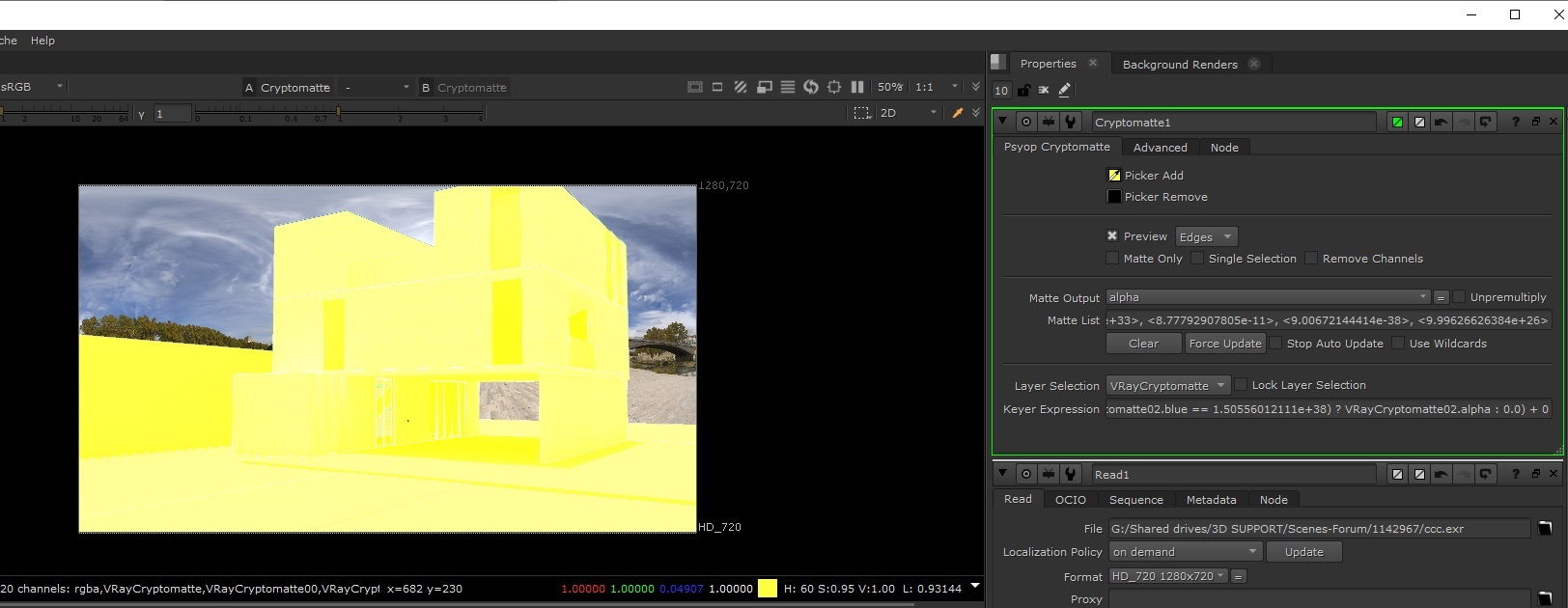

    Hi as far as tested on my end everything works. I created a test scene in 3ds max with background layer and saved and it worked. Also tested your EXR and it works in Nuke?
    Click image for larger version  Name:	Nuke13.0_2022-03-17_17-53-24.jpg Views:	0 Size:	298.6 KB ID:	1143012
    Click image for larger version  Name:	Nuke13.0_2022-03-17_17-59-35.jpg Views:	0 Size:	165.5 KB ID:	1143013

      I'm testing with Nuke 11.3 and ccc.exr doesn't pick successfully.
      The same is Nuke 13.1v3.
      Nuke's problem?
      Screen capture
      https://drive.google.com/file/d/1r9C...ew?usp=sharing
      Note that aaa.exr is an Image that does not include the background. There is no problem here.
      aaa.exr and ccc.exr files
      https://drive.google.com/file/d/1dJV...ew?usp=sharing

        Hi I did further testing. In my initial test it did work now it does not.
        After this confusion I proceeded and was able to confirm that if you load the background image after rendering it does not work but if you load the background image before rendering, render with it and save, criptomatte works.
        Let me investigate a bit further and I will get back to you.

          That's right. After loading the Background, it will not be rendered again.
          It was good to be able to reproduce the problem. Wait for the investigation.
