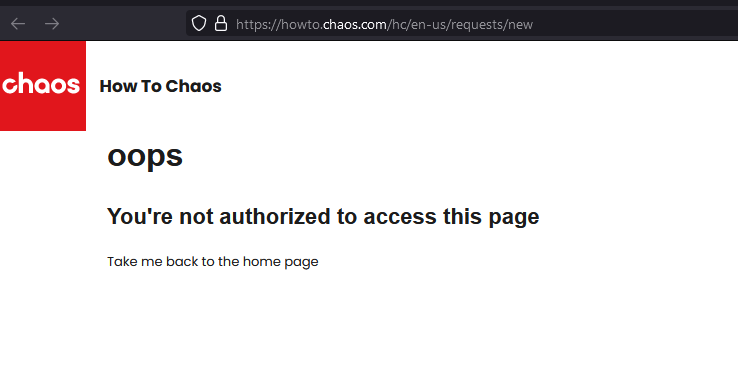

      This doesn't seem to work for me. And yes, I'm logged in.
        Try this link - https://support.chaos.com/hc/en-us/requests/new
        Sorry for the inconvenience.

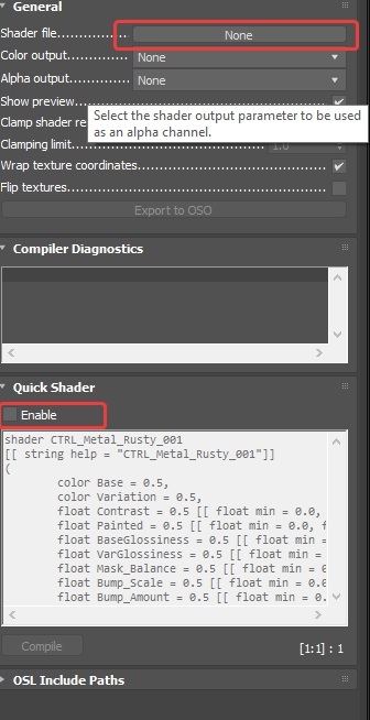

            For now you could load an osl file as a workaround to the resetting issue. If you copy your shader in a text file and save it as .osl, disable the quick shader checkbox and load the .osl file there will be no more resetting.
            Also the values in parameters tab will be dialled back to default. You will have to re-enter them manually.
