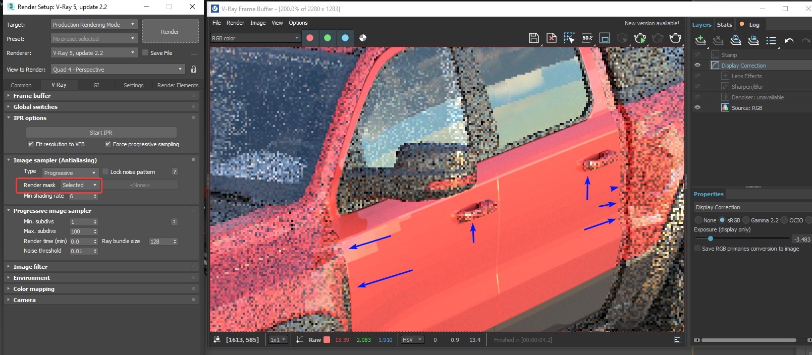

          Hi if you think that an object in the scene is still noisy you can use the render mask in "selected" mode, select the object and render again. V-Ray will render only the selected object. There are other modes as well like layer, include/exclude list, etc.
          Click image for larger version  Name:	3dsmax_2022-05-31_10-37-57.jpg Views:	0 Size:	330.7 KB ID:	1149374
          Another way to do this is rendering a region and your own mask (for instance cryptomatte). You can compose your final image using the mask and rendered region in post production.
