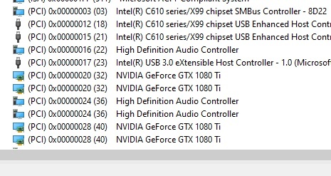

          ok the problem is, missing a registry entry for MSISupported dword = 1
          i studied this a long time ago and it might just be specific to my 1080ti's or the MOBO, but having IRQ's as POSTIVE values, would crash the cards and the whole PC. it would render 1 or 2 times but then crash. i found the solution on the internet. here are some quick screen shots of the IRQ values before and after the fix to the registry i just implemented. also here are the 4 text files i created so that i can quickly import them into the reg (thankfully our local IT person popped up and enter admin credentials when he has the time)
          [HKEY_LOCAL_MACHINE\SYSTEM\CurrentControlSet\Enum\P CI\VEN_10DE&DEV_1B06&SUBSYS_66983842&REV_A1\6&1f49 2daf&0&00400018\Device Parameters\Interrupt Management\MessageSignaledInterruptProperties]
          "MSISupported"=dword:00000001
          i just posted one, but this is done for all the cards i have on my machine.
          also, i don't think the exact number is needed as windows will assign whatever is available.
          so far no issues this afternoon!
