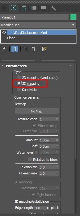

    I used to switch off this filter in the vraydisplacement rollout but now it is not possible to do this. Is it off by default now or is this a bug?

    Hi are you using the 3D mapping/subdivision method. Just checked in 3ds max 2023/vray6 and if you are using 2D mapping the filter is not greyed out but if you use any of the other it is.
    Click image for larger version  Name:	3dsmax_2022-08-15_11-23-00.jpg Views:	0 Size:	40.9 KB ID:	1157161Click image for larger version  Name:	3dsmax_2022-08-15_11-25-22.jpg Views:	0 Size:	40.7 KB ID:	1157162

      Hi I'm using 3d mapping but I'm sure I remember this option being available previously when using this method. I'm using Vray 5.

        Hi you are correct. It was available in V-Ray 4 but since V-Ray 5 it is not. This is done to prevent undesirable results.

          So, is this on by default for 3d mapping because I know that it actually created results that I desired when I could turn it off. Some textures required this option?

            Hi the filtering has been reworked and optimized. It is always on.
