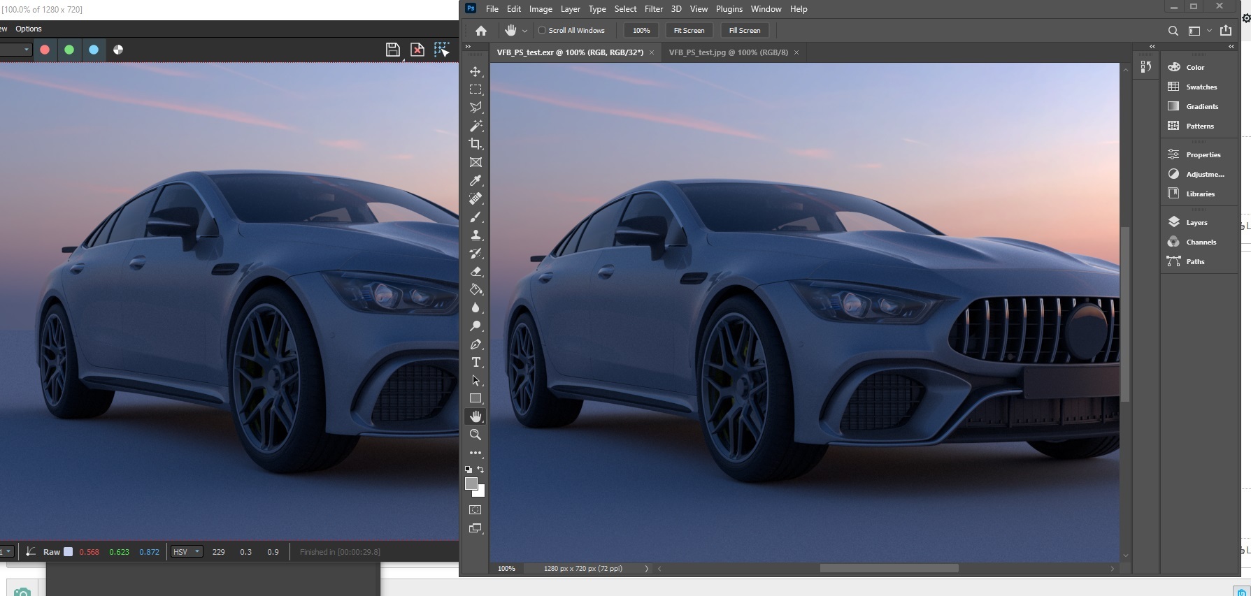

    Hi,
    I get different contrast saving from VFB and opening in Photoshop or windows viewer.
    The image in VFB has more contrast and stronger black tones.
    Any advise on this?

    Hi could you share a bit more details about your setup? What colour space are you rendering in, for example are you using ACEScg?
    You are comparing the rendered result in VFB directly to the same one saved and opened in Photoshop right?
    Keep in mind they will never be exactly the same and there is always a slight difference due to how Photoshop handles the colours. If it is a bigger difference though it could be something else.
    Vladimir Krastev | chaos.com
      Yes, I’m comparing directly from VFB and photoshop or Windows viewer and the difference is in the contrast.
      I’m not using ACEScg. I use LUT with linear and I load ICC profile with mine calibrated one, so the colors are the same only the contrast. On VFB is slightly darker.

        Adobe Photoshop always has had that difference compared to VFB.
        Also as you mentioned there are differences between other viewing software.
        Here is the difference between my VFB and Windows image viewer:
        Click image for larger version  Name:	3dsmax_2022-08-24_14-56-03.jpg Views:	0 Size:	294.0 KB ID:	1157976
        This is expected because the each viewer reads the colour information a bit differently.
        Here is the VFB next to Photoshop (file is saved as EXR):
        Here is the VFB next Photoshop but the file is saved as JPEG:
        And this is exr vs jpeg switched in Photoshop:
