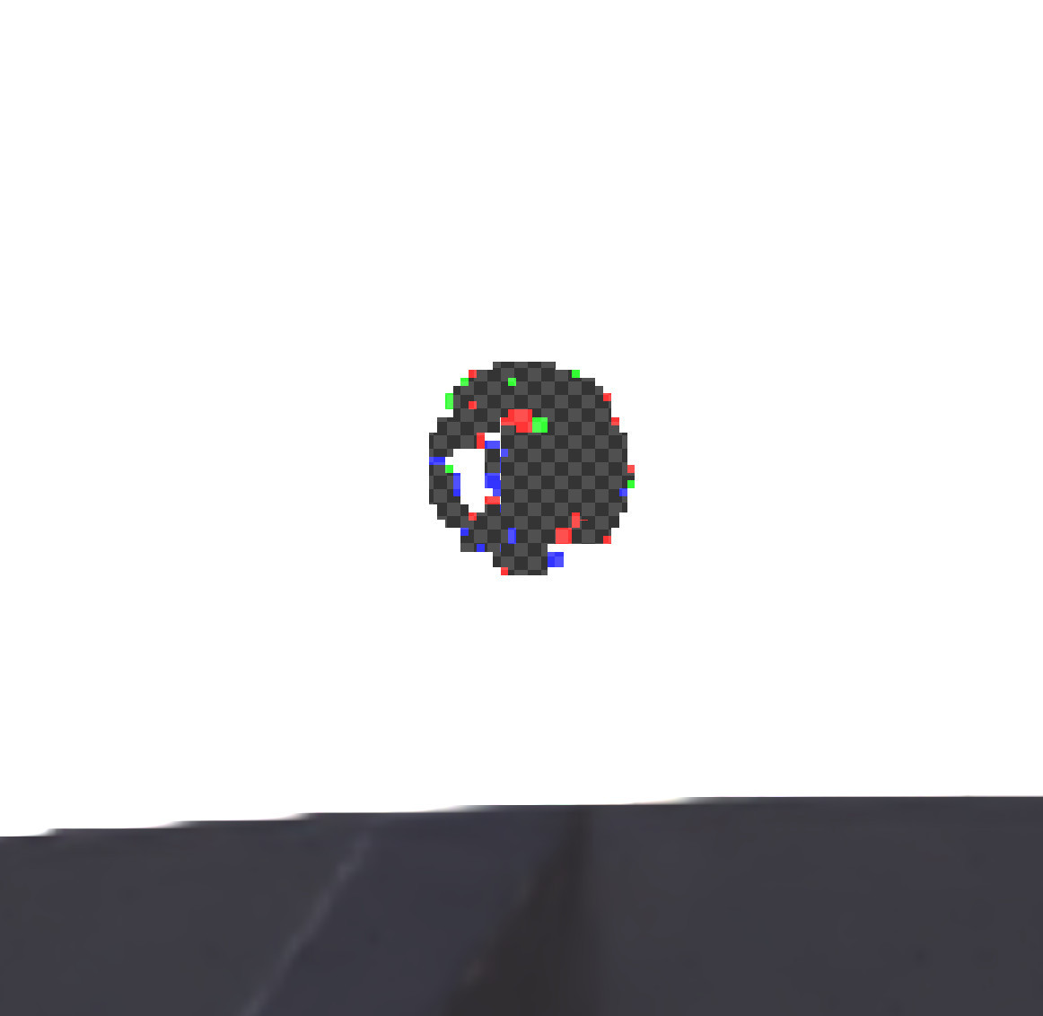

    Perhaps, it's annoying. But I have a problem with the missing colour clamp option in CPU render.
    I have a render I had some problems in post processing (Fusion).. I render in half float (linear) and the image "has a hole".
    When I had this before I just could clamp the colour values and everything was fine but now...
    I tried the script, but it sems not to work with Vray 6. In the Image are pixel with a value RGB value of 64,000 64,000 64,000 and more, it's the vray sun!
    It seems that Fusion can't work with such high values, and some tools in Fusion too.
    In some cases I also got a lot faster render on certain scenes when turning on clamp colours!
    Please bring it back!

    Are you referring to the Color mapping option? If you want a clamped image maybe the "Exponential" type should be of use.
      Yes, I mean the Clamp for Color mapping. I need linear renderings for the postproduction.

        You should simply need to save the image as 32bpc float, for the range issues.

          Fusion should be able to handle values that high. What are your alpha values? You do need to make sure those are between 0 and 1.0. You can clamp those in Fusion with a BC set to affect alpha only, and set to clamp. When you see weird colors like that in Fusion most of the time it is related to bad alpha values (even negative), which some tools can cause due to filter ringing. ( https://en.wikipedia.org/wiki/Ringing_artifacts ). So try the BC clamping after any filters (esp blurs/sharpens).
          I am working with an EXR render that has much higher values than that right now for the VRaySun:
          Click image for larger version  Name:	image.png Views:	0 Size:	1.9 KB ID:	1169494
          It works fine in Fusion.
          VRay definitely has issues with bright highlights (small speculars). This is especially true when using VRaySun. One way to improve this is to use a separate disc VRayLight for specular/reflection, and make that light slightly larger, also don't set its Directional parameter too high (even though the sun is 100% directional/parallel-- try something like 0.3-0.8 tops).
