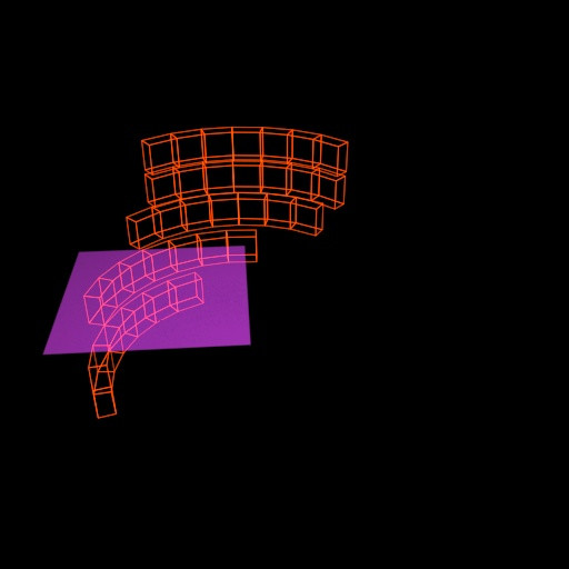

    ​​Hello!
    I made a little scene, here are three images and the scene file , a vrayEdgesTex connected vrayMtl opacitymap.
    1. its good with progressive render mode,
    2. but it loss few pixels with bucket mode, (at frame 16)
    3. put some mesh below, these pixels got back.
ID:	1170274 Click image for larger version
ID:	1170275 Click image for larger version

    Raise minimum AA samples.
      thank you , it works
