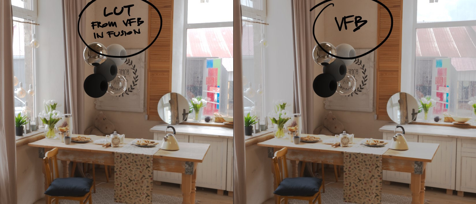

              Sure, you can load them and input for the range covered by lut from VFB should be correct (0-1 max). But what happens above 1 is simple interpolation of last two points of the lut. The interpolation part is software dependant, works in Fusion but might not work somewhere else.

Name:	Screenshot 2023-01-18 184121.jpg
