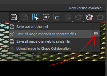

              In that case you need to hold the click on the save icon, then click the little cog-wheel. It will open a settings window, where you can find a checkbox. Enable it and the corrections will be baked into the image when clicking the save icon from the framebuffer. Never understood why this is there in the first place, but never touched it afterwards.

                  Originally posted by JezUK View Post
                  Hi Oliver,
                  Can you explain what checkbox you're referring to when you the little cog-wheel. I don't get any settings window. I get the "Save Image" window (plus, clicking on that cog wheel will save me all the render elements, when all I want is a jpg of the image in the VFB).
                  Thanks.
                  Enable that checkbox and save your render as you normally would. All the corrections should now be baked into the Jpegs you save.

                    Thanks Kosso for perservering with me, I did get that dialog box, and did ensure it was checked and it STILL doesn't work.
                    This is soooooooo frustrating!
